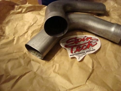

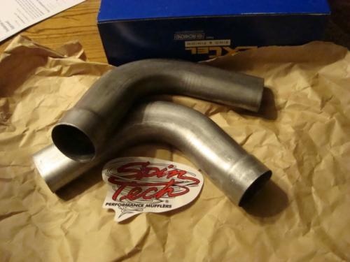

My fansy smansy exhaust pipes came in late last night. These should take care of the problem I had with the driver's side exhaust. If you'll remember, I had to put some pretty big dents in the down pipe to clear the starter, torsion bar and the center link. I know I choked off the 340 manifold's flow so the oval mandrel bent pipe should slide in there without having to put dents in them. They are 2 1/2" ID. These are the ones that start out round on one end (to marry up with the exhaust flange pipe) and then transition to oval to get past the narrow space between the torsion bar and the starter. I also had to order some super tight radius 2 1/2" pipe to make the "more than 90 degree turn" coming off the exhaust manifold. These other pipes should be in today or tomorrow. They have a 3" radius bend (mandrel bent), which is about the tightest mandrel bend you can get in a 2 1/2" pipe.

I received the super tight radius 2 1/2" pipes. I needed these because when I was installing the 2004R I noticed that exhaust place (where I had the down pipes installed) used smaller pipe than what I had asked for on the driver's side. I can't really blame them because they were barely able to snake the 2 1/8" pipe through the small places between the starter and the torsion bar. I'm using a 340 manifold on the driver's side and the exit hole points slightly forward. The guys at the muffler shop put a non mandrel bend in the 2 1/8" pipe and had to bend it more than 90 degrees basically crushing it down. Then to make things worse I had to put some serious dents it in when I installed the 2004R. So now I have the mandrel J bend 2 1/2" pipe from which I can cut a section that is more than 90 degrees. Then I'll attach the oval pipe (posted earlier) to the tight radius pipe to get past the narrow space on the driver's side. This is the tightest radius pipe I could find (3" radius). I'll have to wait my turn to get the car back on the rack before I can install the bigger pipes.
The Passenger's side is OK, there's lots of room for 2 1/2" pipes coming off the Mag truck manifold.

So if I understood correctly you are using a 340 manifold on the driver's side and a magnum truck manifold on the passenger. Would the magnum work on the driver's side or what is the reason for going with the 340 since you are using the mini starter? Also is the passenger side truck manifold the larger 2 1\8 version or the later 1 7\8? Thanks
Hi Trogdoor, I ran across a driver's side 340 manifold for a very good price but couldn't find a passenger's side so I went with the 2 1/8" Mag truck manifold (actually it's a little larger than 2 1/8"). Anyway, I went with the 340 for better flow and used the Mag truck for the same reason to get equal flow on both sides. I tried to fit a Mag truck manifold on the driver's side but there's no way with power steering. I've heard that some member's with manual steering have been able to use the mag truck on the driver's side with a little grinding and swapping to jorgenson type u-joint on the steering shaft.
I have sold two extra mag truck manifolds that I had and I still have two more extra (for the passenger's side). They work perfect on the passenger's side with plenty of clearance everywhere. The best part about the mag truck manifolds is that they don't warp like the stock 318 manifolds, they are thick and heavy duty. Here are some pics of some of the mag truck manifolds I've had. I haven't taken any pics of the other ones yet.
If you look at the last pic you can see (on the passenger's side) from underneath the giant exit hole on the mag truck manifold.
