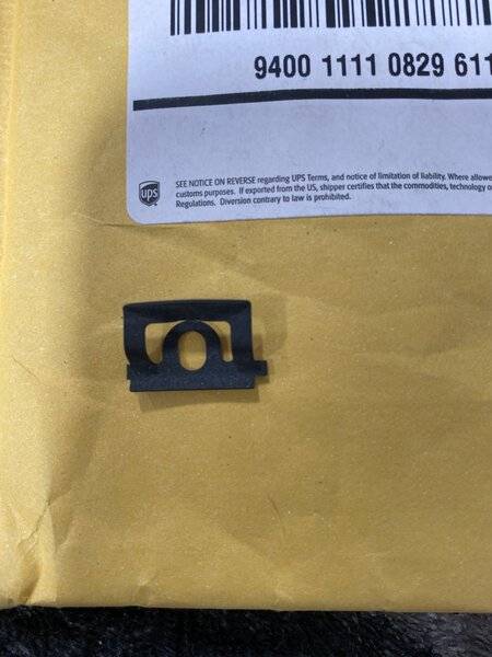

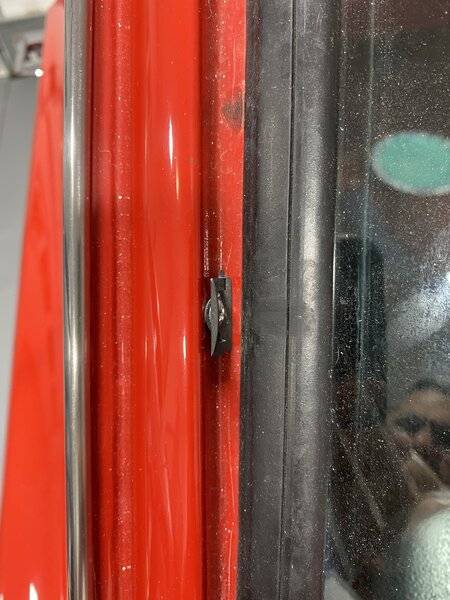

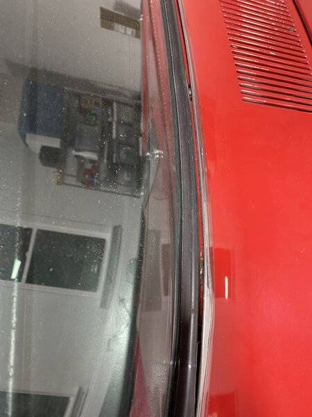

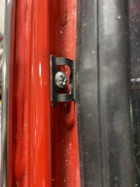

Does anyone have pics on front window clips installed on 68. Lower trim looks to installed wrong. Just bought the car. Just ordered new clips and trying to figure out. Does the round part of the clip goes up or flat part. I guess the clips I bought are correct.
Thanks
Thanks Alan. Just seems the clip sticks up a lot. I’ll pull off the lower trim as the top and drivers side looks good and flush. And just to clarify all of the front windshield clips are the same?
