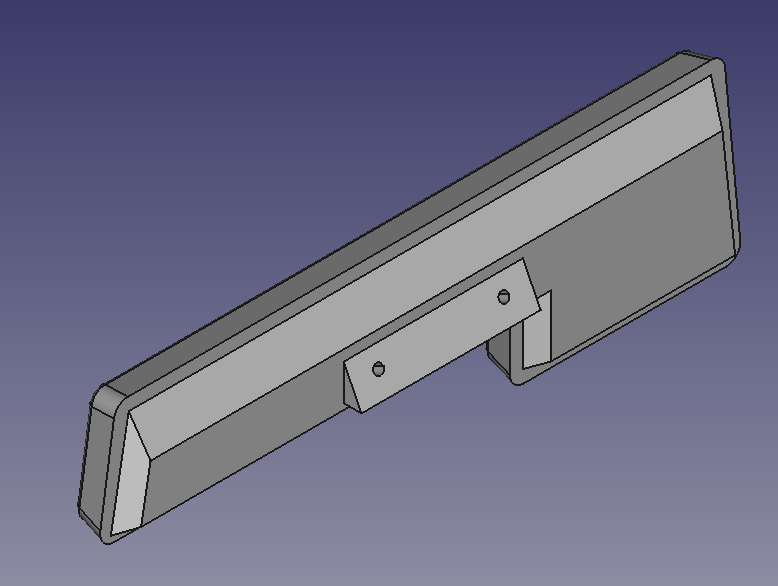

I think if you're going to do this, you're going to need to put pictures of the actual product instead of a pic of the model use to create it. Show people what they are actually paying for.

I've added pictures of the prototypes I printed at home to the catalog listing.

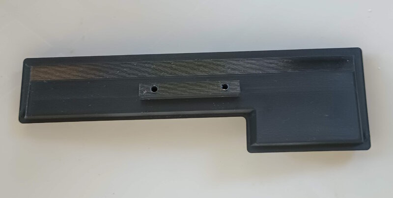

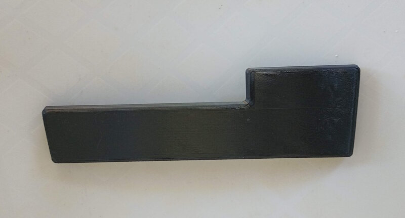

Right now I'm working on arm rests. Here's how it is progressing on the pads.

You may want to state the length of these parts as they are not all the same.
Good point; these are 8 3/4" long at their longest point and 2 1/2" wide at the widest.

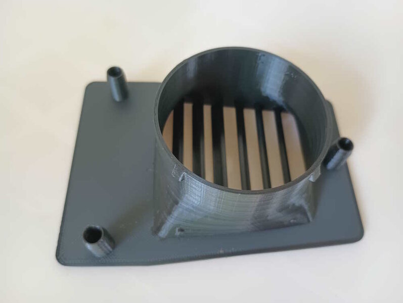

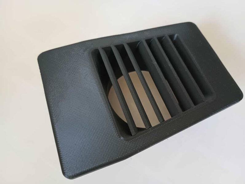

I've found a service that can do print on demand 3D printing, and I'm working on making some reproduction parts based on measurements off my '66 Dart. First one out the gate is dash vents, given how easily they break. I've also made ones to fit the 2.5" stock hose and also 2.25" hose. I can't be the only Dart owner who had a previous owner size the hose to match the heater core outlets and cobble it onto the dash vents as best they could, can I? Well, maybe not, but since they're print on demand parts I can make both.
If you're interested, I have them listed here. I've skipped PLA - that stuff is going to melt if used as a dash vent - and have listed them in polyurethane and resin cast. The print farm could also do stainless steel, but I'm not sure anyone would want to pay several hundred for a dash vent. :)

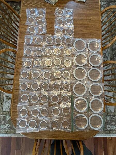

3D printed 64 Dart tail light trim rings. ABS, chrome plated and sprayed with UV protective coating.
