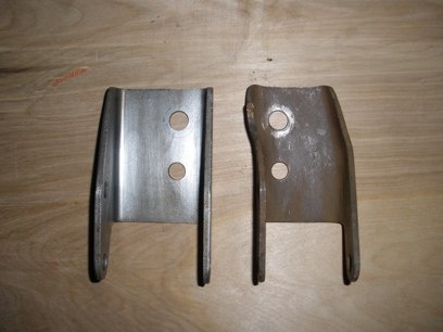

I have THREE pairs of A body 340/360 brackets for Pad style K-members, I want $60.00/set, shipping included. They have the "skinnier" driver side bracket so they will bolt right up to the ears. Send me a PM if you want a set.

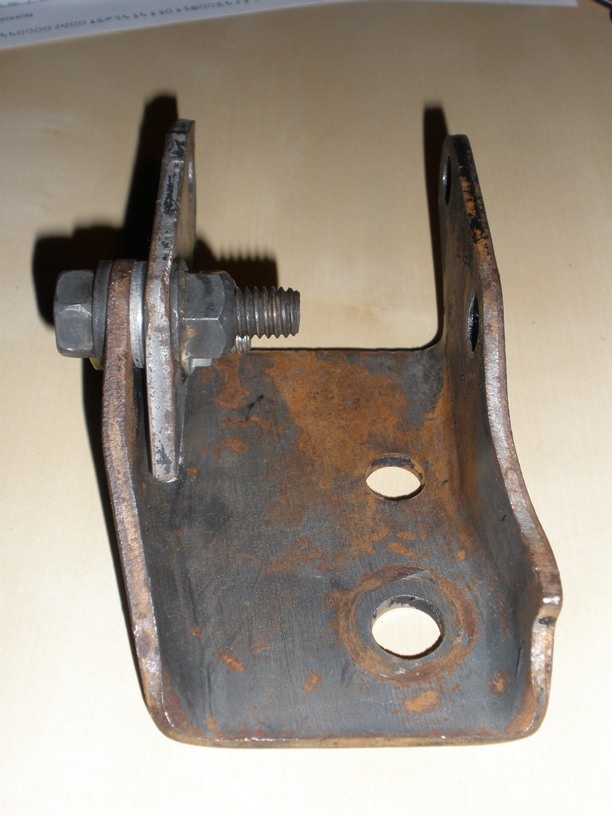

273/318 brackets are the SAME on the passenger side, but the driver side is wider and has one ear hole in the wrong spot. I made my own driver side out of a 318 bracket for my 360 into my 72 dart. I used a Truck 360 bracket and cut it out and rounded the edges as my "spacer ear". Bolted up and sat in the engine bay like it was meant to be there.
