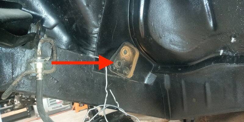

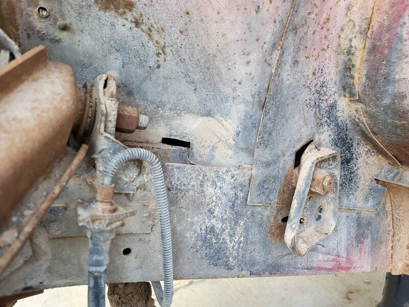

Here’s a few pictures of the bracket on the other side
This last one has the correct bracket, but it's mounted incorrectly, using one of the mounting holes for the ball stud.

The car is a '68 Dart, 340. I figure it was a conversion because there was NO reinforcing bracket on it all when I bought the car. It could be that the factory left it off, but I doubt it. Whoever did it simply drilled a hole in the sheet metal and stuck a stud through it, with a predictable result.

I later installed the bracket that was supposed to be there all along. However, I didn't know about the misalignment at the time, so I installed the bracket to line up with the hole that was already there. If it was drilled in the wrong place, I welded it in place. I could grind it out and try to relocate it, but as others have said, it's probably not worth the trouble.

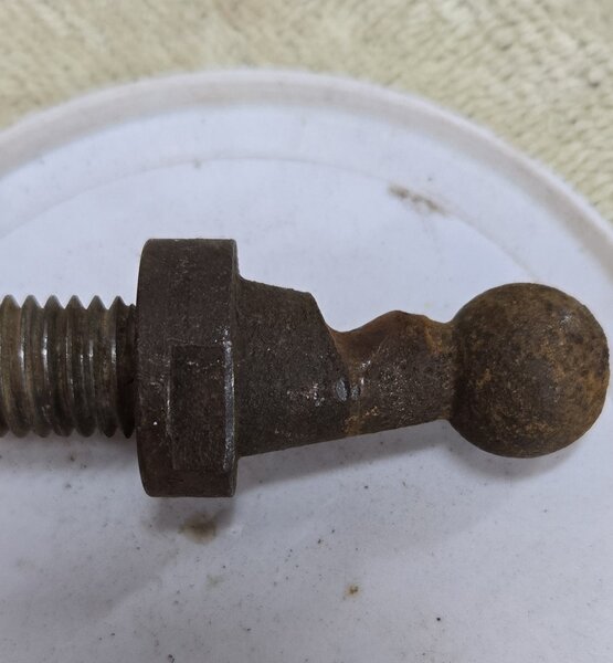

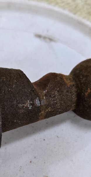

This is the ball stud that I removed showing the result of severe misalignment and poor installation/maintenance. I'm just trying to prevent a similar occurrence.

Where was the cut on the fender side pivot ball when it was installed?

That groove in the old ball stud was from wearing on the end of the z-bar tube. It was that worn out, out of line and wobbly!

Here is my fender bracket, I have some work to do.
