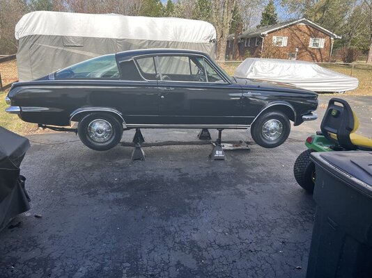

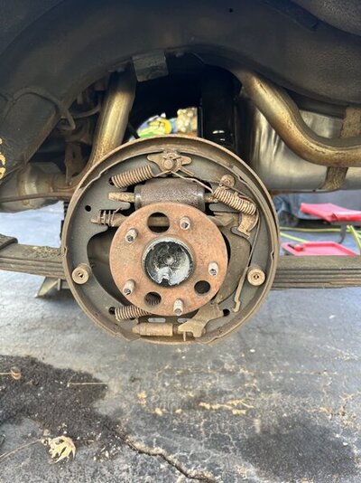

Hey all
Ok, brake, tire wheel issue resolved. After discussing with my wife, and a couple of sleepless nights the brake, tire/wheel issue is resolved. Wer decided to keep everything as stock as we can. So, I am going to replace all brake assemblies. New everything. We will have 4-wheel drum brakes, but they will work. Flushing all lines and will replace lines as needed with NiCad tubing. Wheels are Cragar SS mags, 14 inches, SBP. Tires Firestone F70x14.
Anybody Chime in as to our decisions
What year and model car are we talking? There are stock. (Or period correct options) for upgrading front brakes to disc. I personally would recommend. This upgrade will provide at least 60% better stopping performance. In my opinion.
Ok. That year does have fewer options. But my recommendation still stands. Though the car being lighter will help an all drum option. If they work well? And build is not an upgraded performance? Then you might be right to leave well enough alone.

Are they 10” drums? I believe the Formula S comes with 10” drums in the front which is leagues better than the 9” drums.

Well adjusted drum brakes will stop a car just fiine. Drum brakes aren't as good at managing and dispersing heat as disc brakes so their weakness is in repeat performances. They also don't work as well in wet conditions and require more frequent adjustment. Things I'm sure you have considered, but there is no reason drums won't work fine for your application. Just limit your max effort 60 to zero stop to one and then provide a cooling period.
