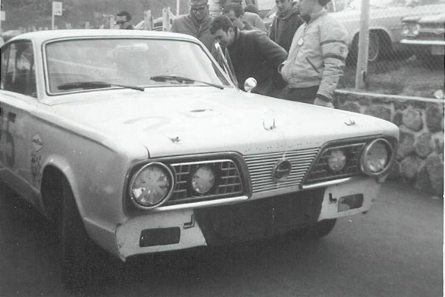

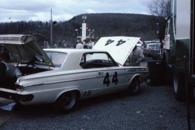

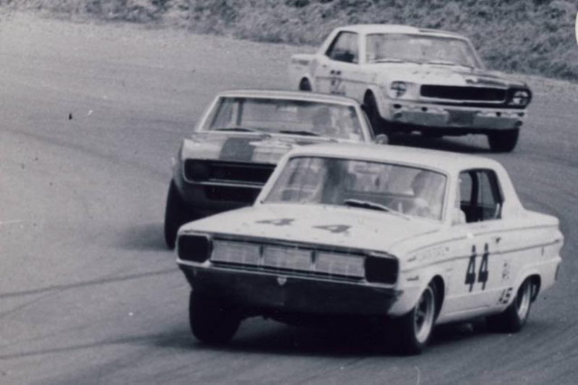

Just so the early A-body guys don't feel left out. These are from the 67 Mont-Tremblant, Québec Trans Am race.
