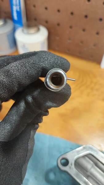

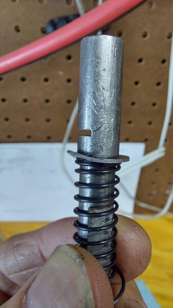

For the park cable, the biggest thing to understand is the orientation of the spring and where the slot is in relation to the drain hole
It's one of those things that once you actually see it, doh, lol
Kinda like un-doing brake adjusters thru the slot, once you see it, understand it .

Great pix.
In the 3rd pic, with the switch out, you just reach thru hole with a thin tool, then lift and hold that wire/spring sticking outta the "receiver/tube", and pull out the cable from the front.
