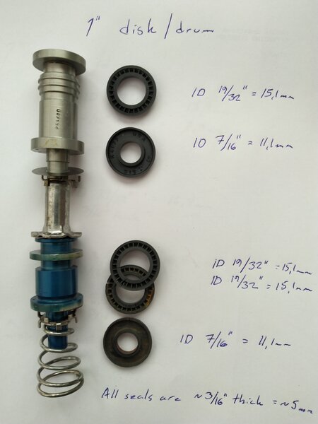

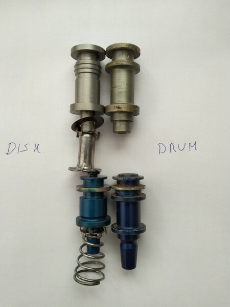

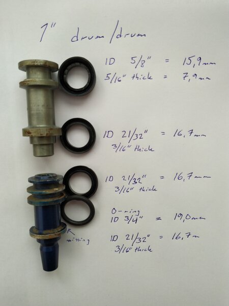

Here's some pictures I just took of the pistons and seals from a 1970 Valiant with original power disk drum brakes and a 1970 Duster with original manual 10" drums. The disk/drum master is #2225541 and the drum/drum master is #2660808. The seals ID measures are actually the OD dimensions of the pistons so the seals should be slightly smaller. Both are 1" bore.

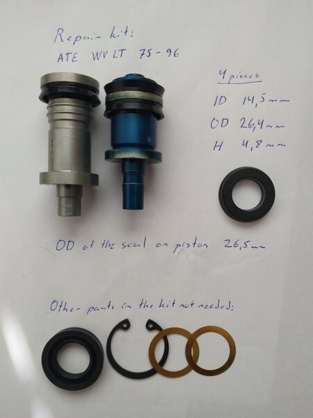

I got the kits that I ordered and made some measuring. Most of the kits had seals with IDs about 15-16mm and various heights that can be used to repair a drum/drum master cylinder but the ID is too much for disk/drum pistons. One kit had seals that fit the disk/drum pistons. (The first picture of the 3 pictures of kits I posted earlier.)
Original seals ID measured from the OD of the piston. ----------->This is a kit for WV LT 75-96. (Frenkit 125044) 3 seals on pistons.
The smaller ID seals were not included in any kit. I'm thinking of making 2 press fit sleeves (11,1mm x 15,1mm x 4,9mm) out of alumina and use the same size seals in all 5 positions. With this kit I would be missing 1 seal. The sleeve could be made for a seal with any ID.
View attachment 1716381030 View attachment 1716381017

I'm 99% certain the pistons and seals in the drum drum master are different than the disk drum.
Look at photos of the two.
