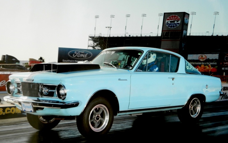

Another option is to narrow an 8 3/4" and go to the bigger bolt pattern. We narrowed the rear end with the 15X8 Torque Thrusts' standard back spacing in mind to center the tire in the stock wheel well. Put 11" drums on back and manual discs up front.
You know that you can transfer the brakes from the 7 1/4 rear(since new) to a bbp rear either 8 3/4 or 8 1/4 and they will work(still need right drums for pattern). I gave away all the 5 x4 brakes from sister-in-laws barracuda, but I did try one of my dodge Omni 5x100 wheels and it was not going to work, but did not bolt it on.
