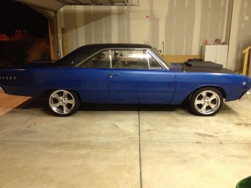

Here we go.
attachment.php
Are those C5`s or C56 ? Hard to tell from the picture.
:oops: As I said: hard to tell from the first picture. Looks really nice anyway though :thumbrig:
I´m thinking of running C5´s on my -69 Dart. C 57´s could be an alternative

what kinda of wheels are these?
