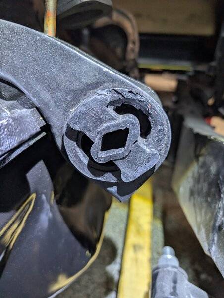

Hey all,
Posted below are some pictures of the engine mounts that I am going to use in my truck. These slant engine mounts have a weird diamond shape hole, they're off of a 74 dodge dart with the Slant. I need to know if there is a sleeve that needs to go inside the bushing, or if anyone can rattle off the best size bolt. I want to make sure I do this correctly so I don't have to go back when the steering and exhaust is in the way. Not only that, but I included a pic of the engine as a whole because it looks dope, and I'm excited to share.
Thanks for the help folks,
- Coop

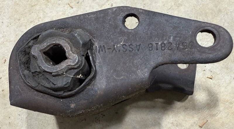

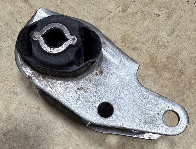

These are small block mounts, but yes, there's a metal sleeve that's supposed to go inside that bushing. I'd also add that based on the look of that bushing, I'd replace the whole bushing before I installed that engine.
This is a reproduction mount
This is an original (with an equally smoked bushing)
That seems so strange to me, these are brand-new engine mounts that I got off of Rock Auto. That was likely my first mistake, I'm just not understanding why they seem to be missing the inner circular metal sleeve that every other engine mount I've ever seen has. If anyone has a link for these spool type (They might not be spool I'm pretty sure they are though) I'll get a better set.
I'm thinking the metal sleeve got coated in rubber, and you're looking right at it maybe?
Could be, it definitely feels like steel and not rubber on the outside. I just can't for the life of me figure out why it's in the shape of a diamond and not a circle like the other 500 engine mounts I've installed over my career. A half inch bolt feels loose, which is what I found recommended in the Dart service manual. I am going to run to the hardware store later and get a couple bigger sizes in grade five and see what works best. Taking the engine mount off I mean, I need to replenish my shop bolt stores anyway

****, maybe! Never considered that, I'll reach out and see what they say. To clarify though, it doesn't have a circular bushing though, right? Just a tab on the bolt.
Yeah there isn't anything extra compared to say the top picture I posted. The bushing itself that's pressed into the mount is a metal sleeve with the rubber inside of it, and then the metal sleeve for the bolt.
The bolt itself just had a little crimped section. I don't know what the purpose was, to keep the bolt from spinning when you started the nut? To keep the sleeve from spinning on the bolt? Beats me. It's really small, so it's not like it would take much force to spin the bolt in the sleeve. You can kind of see it here, it's like the used a crimper of some kind to make a little tab out of the bolt.
Needless to say a regular bolt would work just fine.
