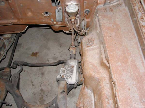

So, I’ve been kicking around on FABO for about a year now and I finally (just before Mopar Nationals) got my car into the shop. To this point the car’s been in storage and I’ve been able to take inventory (the car was a basket when I bought it), do some disassembly, cleaning, painting, and scrounging for parts, advice, and ideas while trying (I’m really new to this) to help friends get a couple of other cars ready for Columbus, OH (see FABO member fourspeed’s “Dirtbag Duster” build).​
The car was someone else’s project that sat untouched for about five years in its current condition, which is pretty damn clean. It’s a ’64 Valiant Signet200, 273, four-speed. Should be a really fun little car.​
It was pretty complete as far as parts go. The motor was fresh out of a shop, but that will get torn down and re-built - Commando style with dual exhaust. The transmission and bell housing were included and an 8 ¾ rear end is in it (the previous owner had a spool in it which will be replaced – the setup will be a cone-type Sure-Grip with 3:23 or 3:55 gears). All of the glass but the windshield came with it and all of the trim was there (minus some insignia, etc.). The dash assembly is pretty solid (some cleaning and refinishing required) but the rest of the interior will be redone from scratch.​
Many thanks to all FABO members who’ve already helped me out. I’ll try to keep posting as the car progresses…hopefully be ready for ‘Nats 2010.​

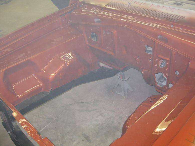

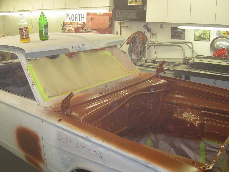

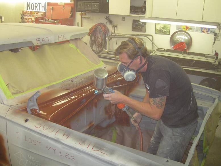

The remaining components were removed from the engine bay. It was then cleaned, prepped, and painted – two coats epoxy primer, two coats color, and two coats clear.​

The color code is FK5. It's a 1970 (I'm told) Plymouth color, 'deep burnt orange metallic'. It looks a lot better without all the clear-coat haze in the air.

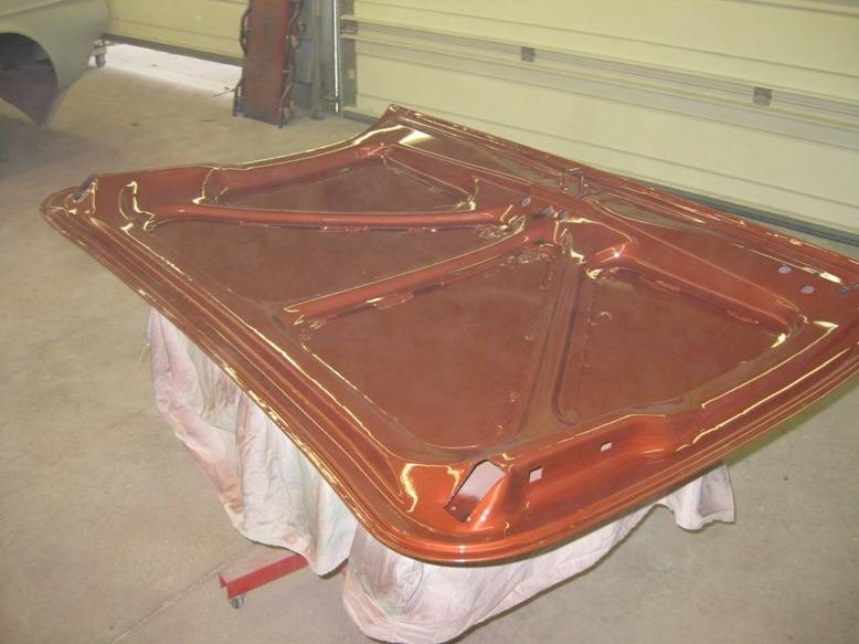

The door jambs, interior door surfaces, deck lid drip rail, and the undersides of the deck lid and hood have all been prepped, primed, sealed, painted, and clear-coated.

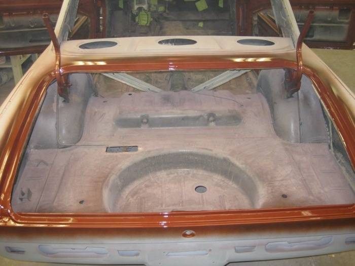

- Interior floors prepped and painted
- Trunk surfaces prepped and speckle-painted
- Dash stripped, prepped, and painted...should look great with the chrome trim and pad in place

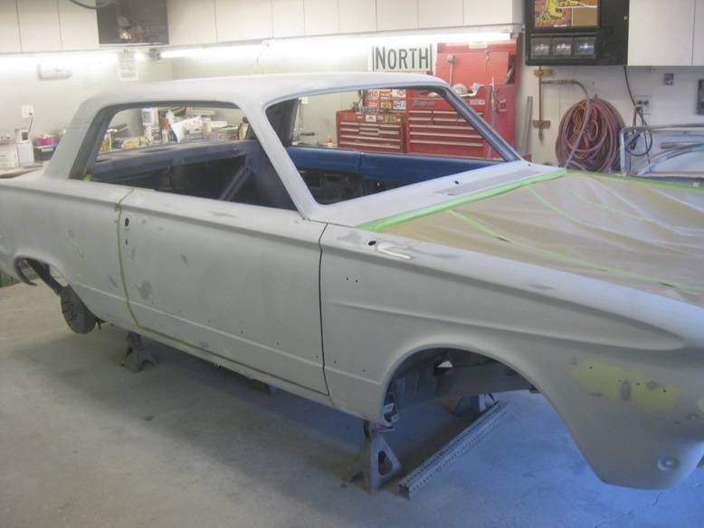

- The major body work is done and the whole car is in filler primer, waiting for spring so we can get the color / clear on it

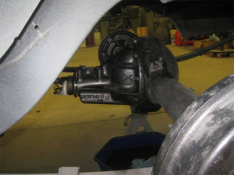

On the mechanical side of things...
- All of the front suspension components and K-member are blasted, prepped, and painted. Everything is re-assembled out to the spindles (thanks Waggin!).
- We added an anti-sway bar, Craig did a marvelous job fabricating mounting brackets.
- We completely rebuilt the rear end - 355 gears, all new bearings, cone-type Sure-Grip (never been in a car), new yoke, Green axle bearings, and re-built drive shaft.
