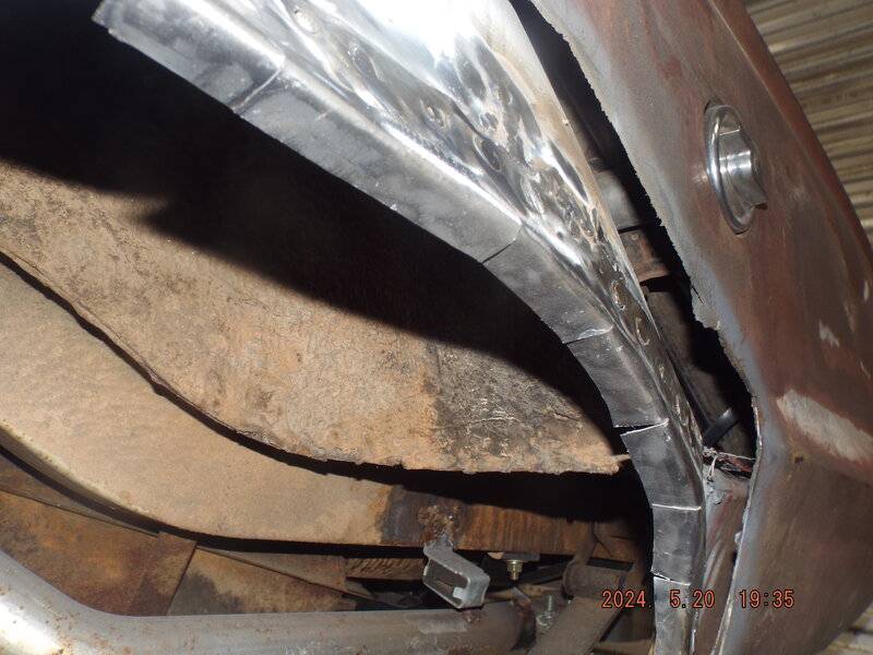

I'm not a welder and I'm not a bodyman, but I've made some progress on Vixen's outer wheelwell. I gave up the first attempt and ground it back off. I flattened out a piece of scrap fender and cut the basic shape. Cut small slices in what would be the 90 degree turn in and bent it in. Then I used the quarter patch panel as a template and shaped the outer wheelhouse panel to fit it. "For me" it turned out ok.
I also went ahead and cut the lower portion of the rear quarter off all the way around to where it welds onto the valance panel. The driver's side trunk drop off needs the first 3" of the bottom replaced, but I can make that. Now I gotta save up for the rear quarter patch panel too. That will be a bit. lol
^^^ Thats how I have done it many times.

So here it is after cleaning it all up and a coat of undercoating. Turned out good for me. I have about another 5-6 inches on that very back curve going down to the bottom of the rear quarter. I also cut off some of the bottom of the rear quarter in preparation to replace that piece as well. It'll be easier to replace both pieces at the same time so I can get everything lined up right. It needs the trunk floor drop off too on this side, but I have to fix this one, because it's just not in the budget. It only needs about the bottom 2-3 inches replaced anyway and I can make that out of scrap sheet metal.

^^^ Good deal!!!! Its called gettin it done best ya can with what ya have!!! BUT... don't let that group of guys call you a hacker or worse! I always wonder about that group of guys....... Are they just so talented and skilled? do they have enough $$$ to have all the best tools/equiupment? do they spend months doing what we do in a weekend?? Just wondering?? They they just pay a big $$ shop to do it???? :BangHead:
Looks like you done a fine job to me! If it seals up to the quarter and keeps the road crud from getting inside.....it'll last long past when we're all pushing up Daisies! :)
:thumbsup:
I've had the quarter patch panel against it several times and it mates up good.

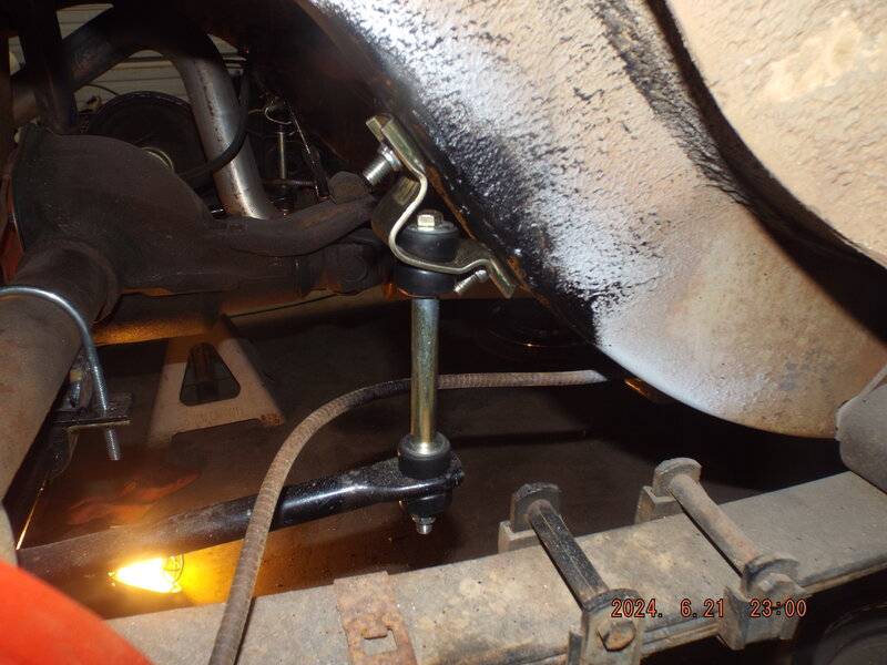

Ok, so I finally got around to installing my rear sway bar on Vixen. It turned out ok. I had to get some 2.5" u bolts and fab up some C channel brackets for the rear end tubes, since the 7.25 uses 2.5" tubes and of course the kit comes with 3" brackets and 3" u bolts. But that was no big deal. I also had to get longer link kits, as the links in the kit were way too short, but it's all worked out now. Notice on the frame attachment for the links I cut two 1/4" plates and welded them to the frame rails for reinforcement in that area, since it's a common problem for the little u bolts that hold the link brackets to the frame to actually tear out of the frame. I wire brushed that whole area and then sprayed it down with rubberized undercoating. Anyway, here's the end result.

For sure...now RRR and the little woman will get to the cafe for lunch quicker now!!!! Actually.... good size sway bars really make a difference.
Years ago I bought my first BB A body, a 67 Cuda 383 4 speed, The PO had installed a big front aftermarket sway bar, it took corners almost like a Vette..almost.
Well, my little brackets I made didn't work out. They kinda crushed under the load and caused the nuts holding the sway bar to the rear axle to back off. That's ok. Stay tuned. I got somethin for all dat. LOL
