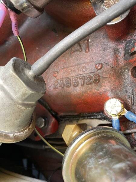

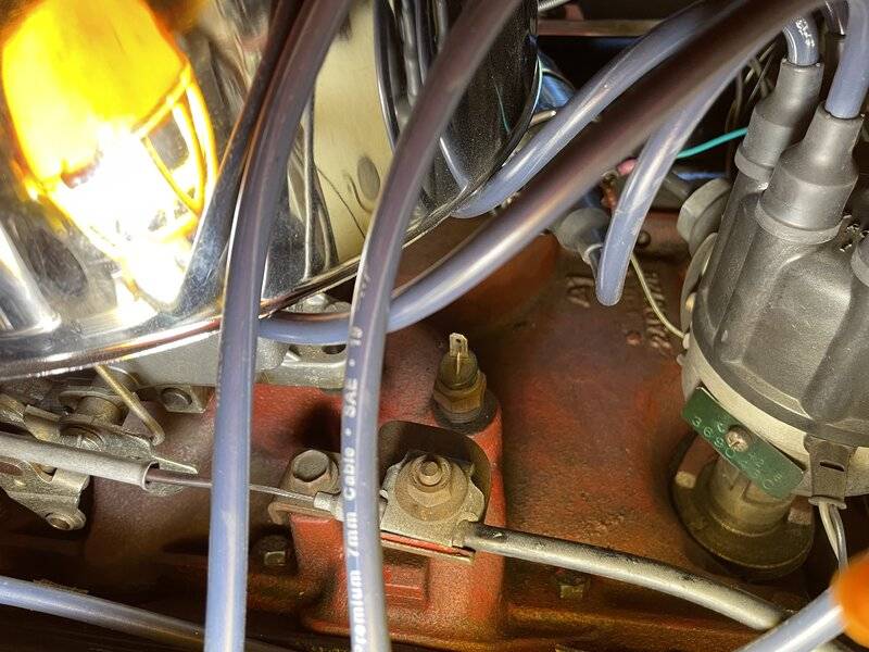

1965 273 4-bbl intake. What is this connector for?
That casting goes ALL the way through the intake. I wonder if they put it there for an optional PCV or crankcase breather?
Just a bulb shape on the bottom side. It doesn't feed into the runners. In 66 the CAP (first year) was a hose from the air cleaner to a vented oil cap.
Dang, all the photos of my engine I only have a couple of my intake and none of the underside. I wonder if I can get upstairs in my garage. I think I have a extra intake up there. I think it's a 66 non-CAP.
On a California car (Barracuda) in 67 it had a port going to the CAP valve and a port going to the vacuum gauge. If you had power braked it would have come out the top.

You could connect a couple wires to it and try any gauges you have. Maybe you could monitor intake air temperature or vacuum. (smiley face)
Mine is multi function, brake boost & heater/AC control. Originally it was just heater/AC control till I added power brakes.
What was the original use for the vacuum? I’d guess a power steering unit given it’s location but this car never had power steering. What sized bolt is that plug Mike? 3/4”?
r u sure its the oem intake for the 273 & its not from a lator 340 or 360?
It is the original intake with correct casting #. A later intake will not work on a 65 without modification. The mounting bolts are different angles.
Yep, someone just plugged the hole.
