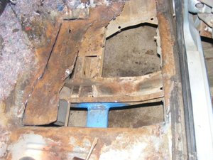

Hi all next step :-))
Today 3.5-hrs time had.
wants to change the thanks lid
Ground metal driver's side should be completely substituted, first part to cut out
Saturday after the work it further goes.
I will hold to keep up-to-date
many thanks my Fabo dud´s for comment´s.
Regarts
Uli

THX my FABO Dud´s for comments !
Next litle step
Ground metal tin-plates!
Grundmetall to shrink-wrap
Greetings from snowy Germany
Uli :-)
