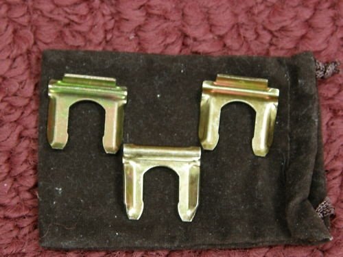

After adding the front brake hoses I found out that I don't have the front clips holding the hoses to the bracket. I searched on ebay and found two styles. They are the same but the finish is different. Ihave a blackphosphated on the rear brake hose.
So my question to the FABO world is if some one know what finish they came with?
Thanks FABO!
Thanks FABO!
According to Roger Gibson the brake hose clips should be black zinc and I was able to buy three from him. Yes!
