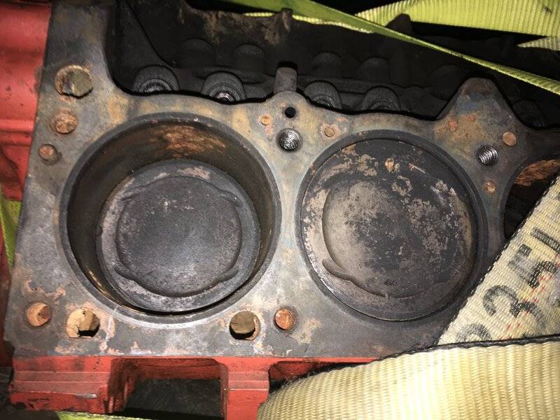

I recently scored a ‘68 318 for my ‘69 Dart. I’ve heard lots of good things about the earlier 318 blocks being beefier and the ‘68 318 having 9.2-1 compression ect ect. Anything special about the crank or rods? I also noticed it has open chamber heads, so if i put my closer chamber 302 heads on what kind of compression might I be looking at there? Blocks getting torn down and rebuilt, but i’d just like to know what to expect to find. Thanks all!
I don't remember my '68 having pistons like that, but it's probably a cast crank like mine was. You will get an increase of compression, but I would honestly be surprised if that combo had over 9:1 as is.
First off the blocks aren't any heavier than other 318 blocks. A 68 should have a steel crank instead of a cast crank which is good. The #302 heads will add about a half point of compression so you are looking at about 9.5/1 or so.

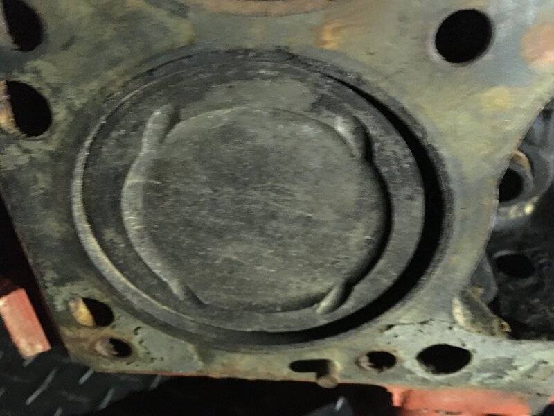

Those pistons, look like badger or sterling brand. Clean the center and look for an overbore stamp, I think it's been rebuilt.
Those dished pistons do not look like the '68 - '69 flat top 9 2:1 with valve reliefs.
Here are the pics of '69 Pistons below and I have another set of '68 pistons that look just like them, factory mopar 318. They sit .040 ths down in the hole at TDC, and have full floating rods.
302 Heads, 714 castings are the same head too.
My original pistons (69 318) were .030 down in the hole.

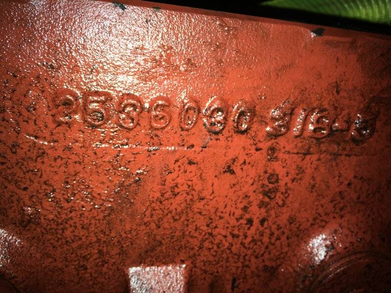

Actually a 69 318 being the casting date is 10-31-68 but there is nothing special about 68-69 318's...
