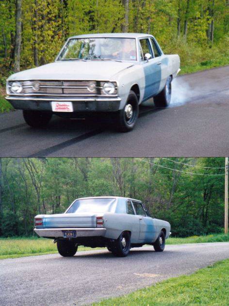

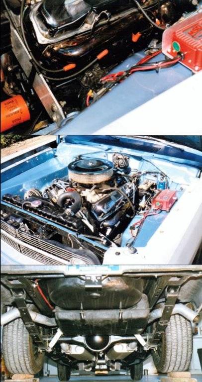

Here's a 68 Dart with a 500, that I did a few years ago. -- It was a ATI auto - Motor plate - TTI Headers - 3" exhaust, exit like a Nova - Cut outs - Flow Masters - 850 Holly - MSD - 8-3/4", 3.55s - Moser axles - Frame ties - SS springs. Just to name a few mods. --
Here's a 68 Dart with a 500, that I did a few years ago. -- It was a ATI auto - Motor plate - TTI Headers - 3" exhaust, exit like a Nova - Cut outs - Flow Masters - 850 Holly - MSD - 8-3/4", 3.55s - Moser axles - Frame ties - SS springs. Just to name a few mods. -- View attachment 1715105732 View attachment 1715105733
Great looking Dart! Did you have to run a motor plate or just chose to for ease of install? I was thinking of going with the Schumacher conversion motor mounts but I'm hoping I'm not going to run into issues with the TTI 2 inch headers and having edelbrock heads like I did on my last Dart.
-- (1) Did you have to run a motor plate or just chose to for ease of install? (2) issues with the TTI 2 inch headers --
-- (1) I just chose to do it. It helped with weight transfer. I ran it, almost daily, on the street, and it turned 11.23 @ 123 MPH. in the 1/4. With a few tweaks, it was a high 10s car. -- (2) I had to run the torsion bars thru the headers - that was a PITA. -- If You have more questions, I'll be glad to help. - Let's do it via PMs.
did u ever run it at the dragstrip ? If so, what did it do ? -------- kick a$$ car !
did u ever run it at the dragstrip ? If so, what did it do ? -------- kick a$$ car ! --
-- 11.23 @ 123 M.P.H. -- With a little tweaking (dominator, 3.91s etc.) it was a 10 sec. car.
