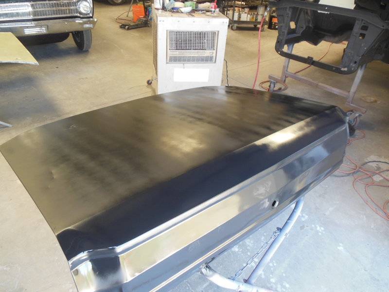

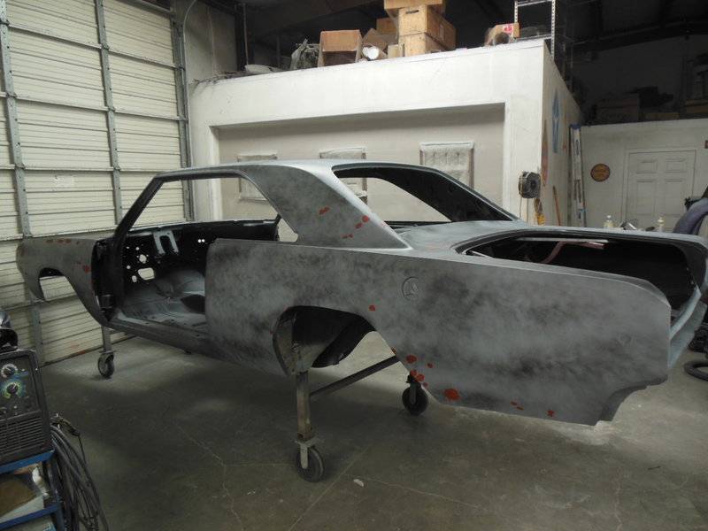

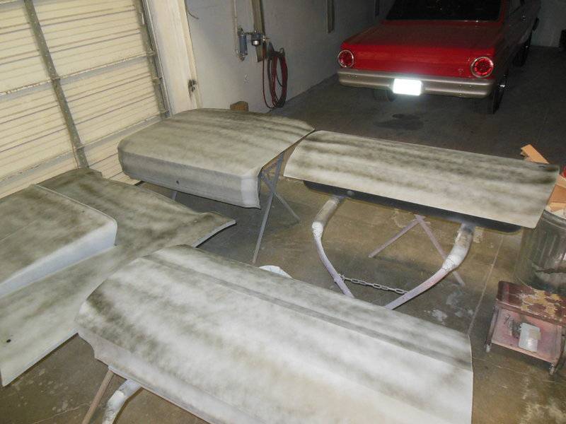

Current progress on the LO23 Dart includes completed body work after complete sandblasting. Greg is wrapping up a trip in North Carolina where he has researched what is probably the most original 2 owner unmolested survivor of an LO23 Dart out there. He has done this in an effort to restore the LO23 in the shop as correct as possible. From what I know, the car he has researched was campaigned for maybe one season, sold to the current owner, and used only for the occasional show. I will notify you once Greg is back in town and I have more information.

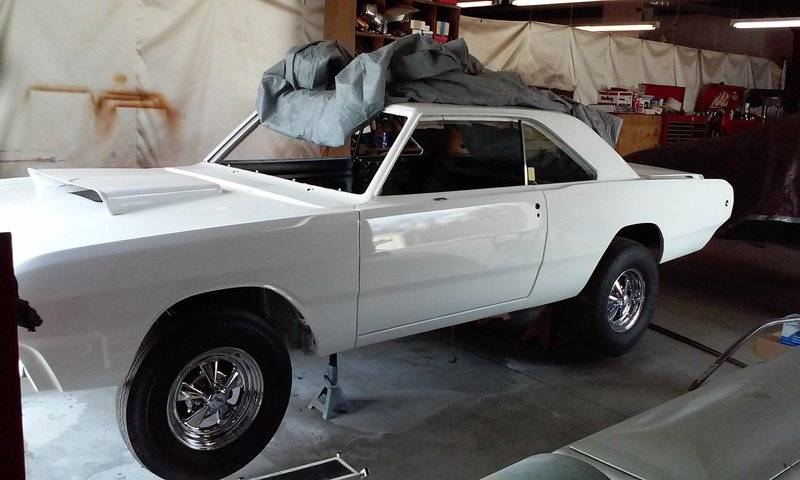

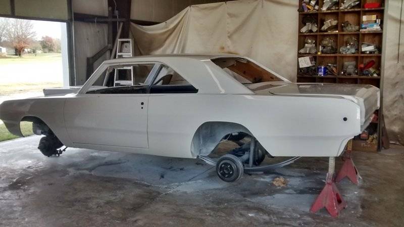

Current stage of my LO23 Dart Clone includes the completed body work & paint. The wheels have been installed.

Dart looks awesome! Gotta ask, what's up with the casket in the garage???? I keep a lot of different things in the garage, I just don't see me ever having a casket in there! Mind you though, I still have the ashes from my dog I had put to sleep a few months ago laying on the arm of my couch where she spent a lot of her later years laying when I wasn't home.
I just love this S/S forum.
Thanks for the kind comment. That casket belongs to one of my Mopar friends. He is making something similar to the Munsters car and installing a small block 318 or 360 in it. I agree. This SS forum is awesome

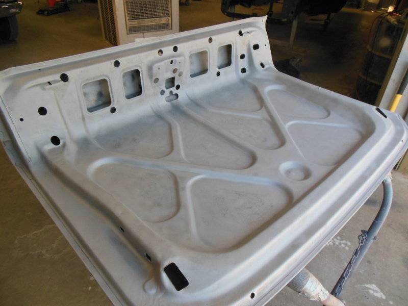

The owner decided to run the vintage Hemi Orange paint on the LO23! Awesome color choice. It looks metallic in the picture because of the way the light is hitting the curve of the scoop. It is not the newer metallic version. The hood, doors, and trunk lid are all painted with the body soon to follow. Also pictured is the correct 1968 4 speed steel bell housing. That sucker ran $1300.00!
