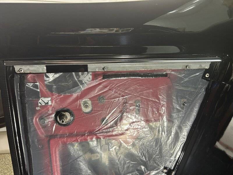

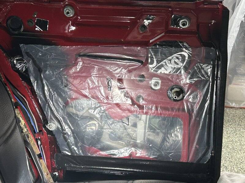

1969 Barracuda 340 Formula S Restoration

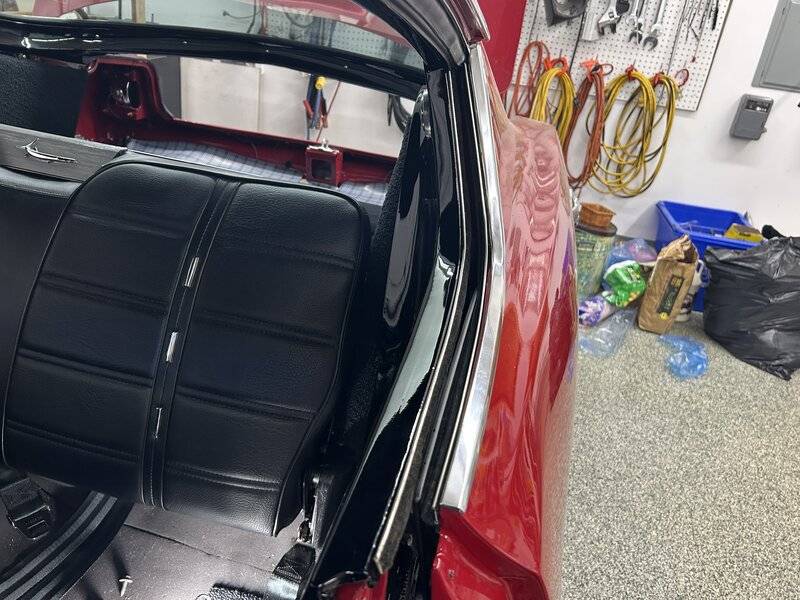

Drivers side rear window area finally finished!
Next is passenger side.

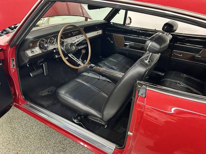

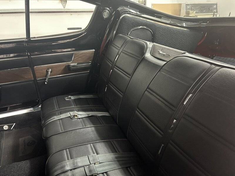

Big Milestone today. Finally finished all the interior!!!! Next up is finish hooking up the Holley Sniper Fuel Injection system and see if it will start.

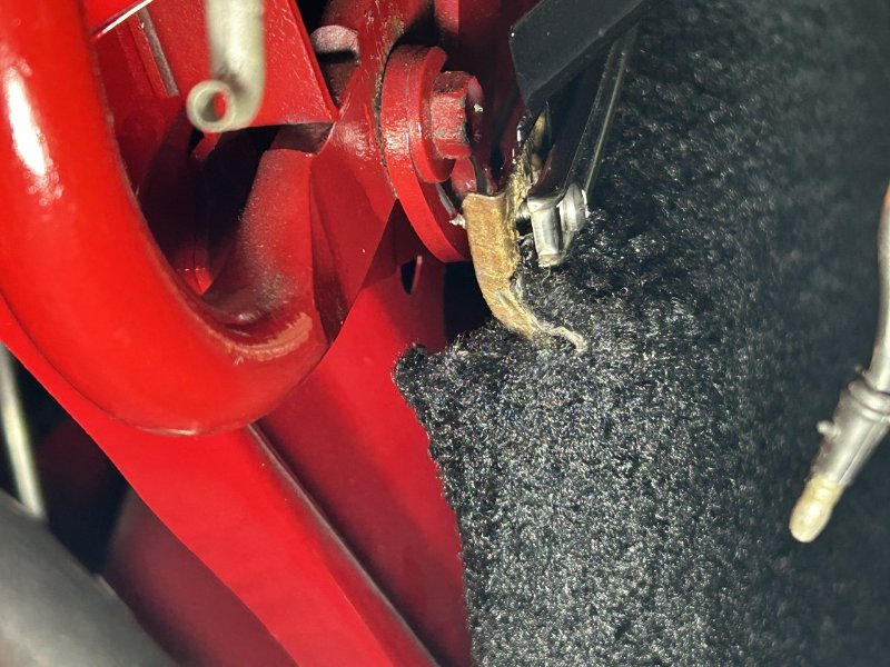

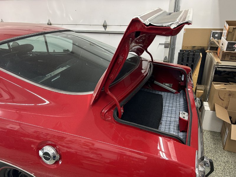

After a long delay, back at it again!! But first a question. Does anyone have a fix for a rear trunklid that won't stay up on a fastback?? I've got mine adjusted as much as it will go ( I think). Seems like the coil spring is weak.
, but just barely stays open.

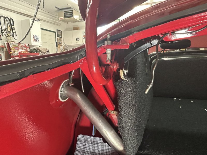

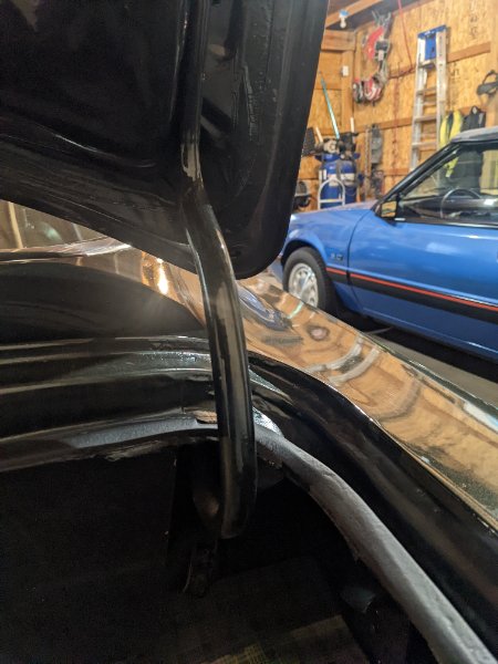

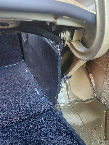

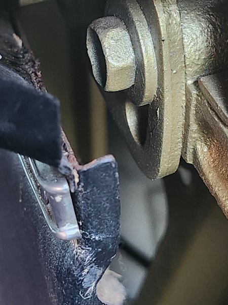

Here's ours Jim, we havent done any adjustments on it. Prev owner did a great job on the car.

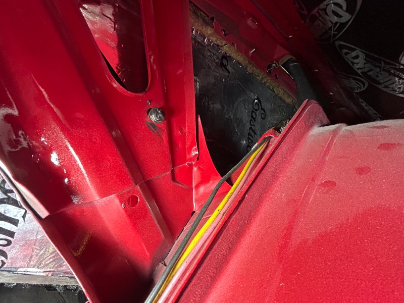

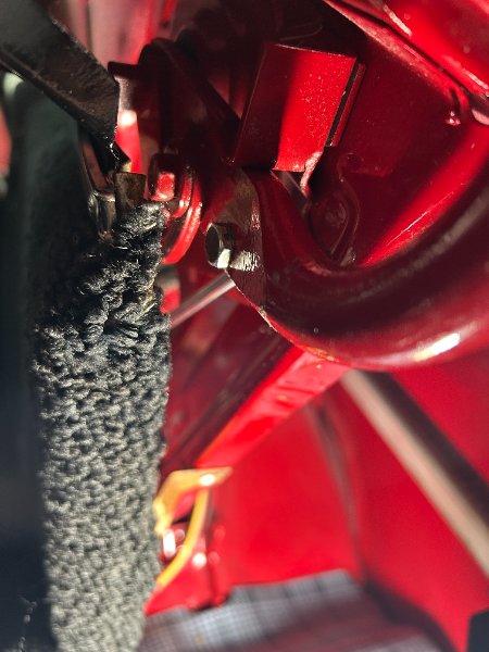

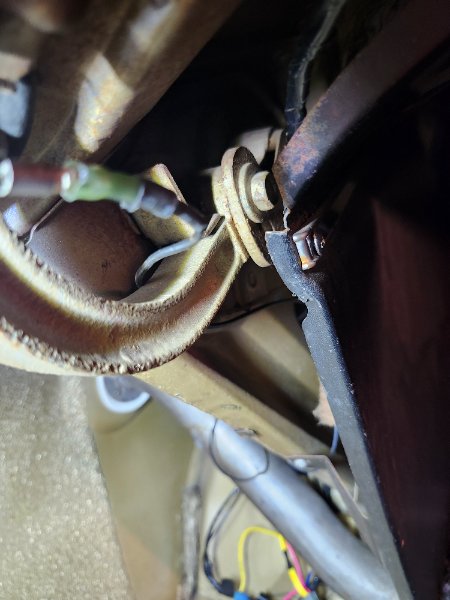

It looks like ours(pic of pass side) has a slightly different position. With yours the bolt with washer is dead flush on the hinge. On ours it sits approx 1/4" down?
Hope this helps. I can take more pics/measure if needed.

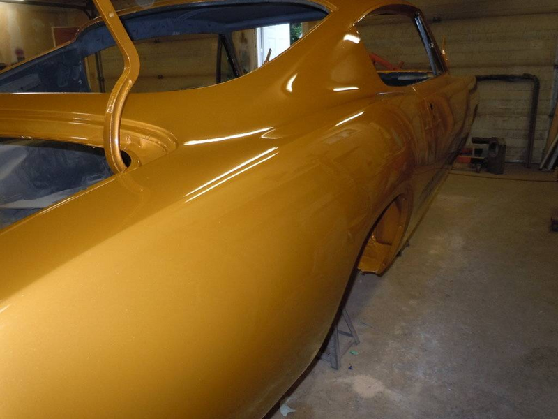

Unrelated to the tension, noticed your arm is completely different design than mine.
That's very interesting..

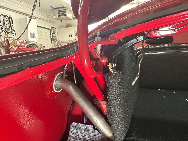

Here is a pic of mine and they look exactly like Steve's on his 67
Mine is a 68 and these are the originals. I am the only person to ever disassemble the car , original paint on them so the hinges have been there since new.

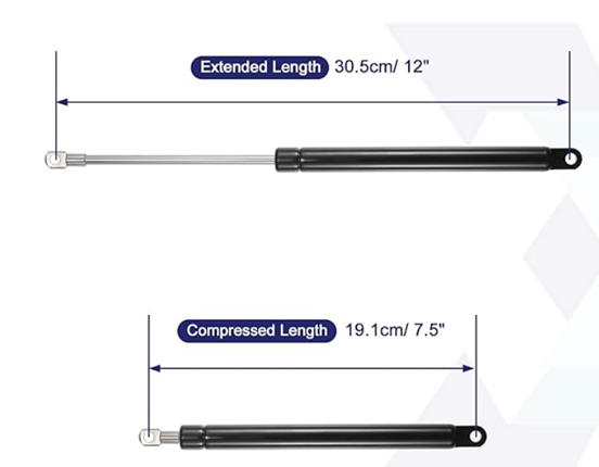

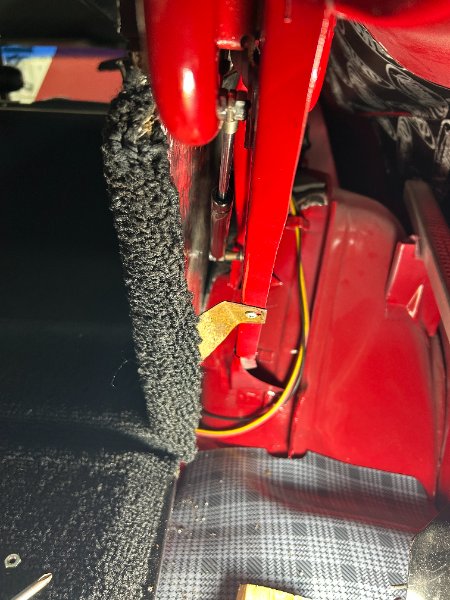

A long way from factory original, but I solved the saggy decklid issue!! I installed a 24 lb gas strut to add support for the lid!!!
Jim
