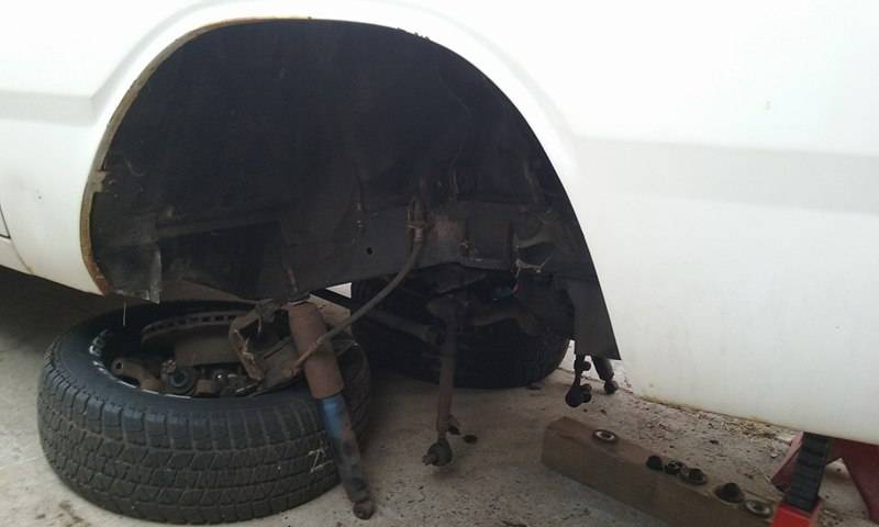

I also took apart the donor cars front brakes getting ready to put on my car.

Wow that rusty donor sure dont look too rusty to me. When you get ready to strip it out, theres a lot of metal i bet people will be looking gor out of it.
