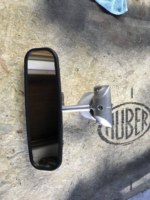

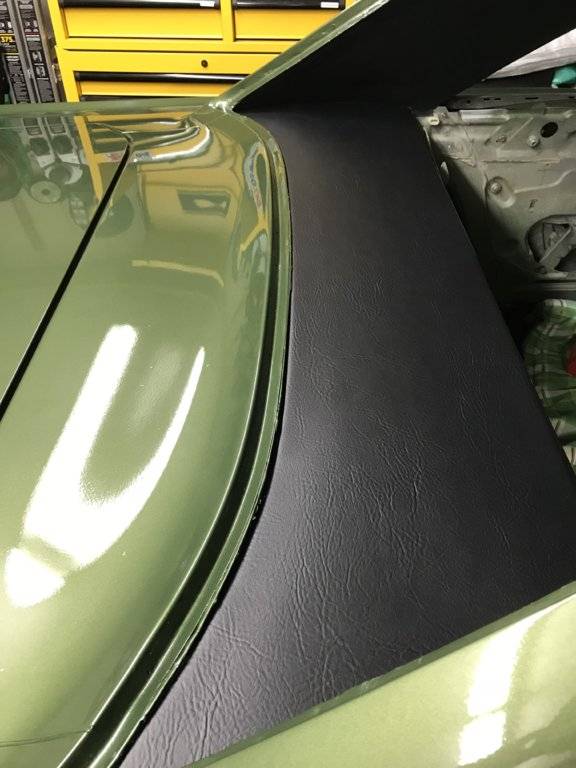

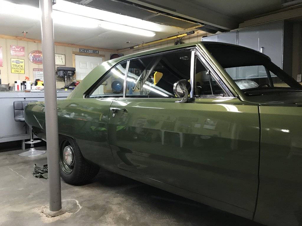

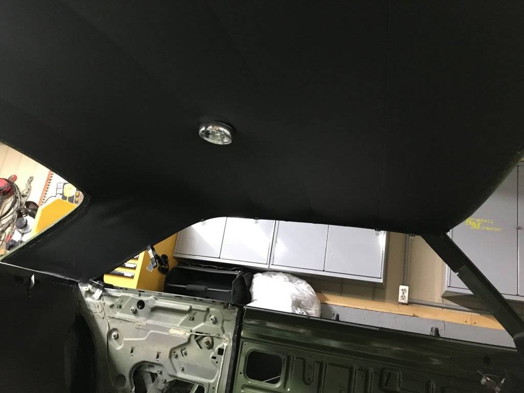

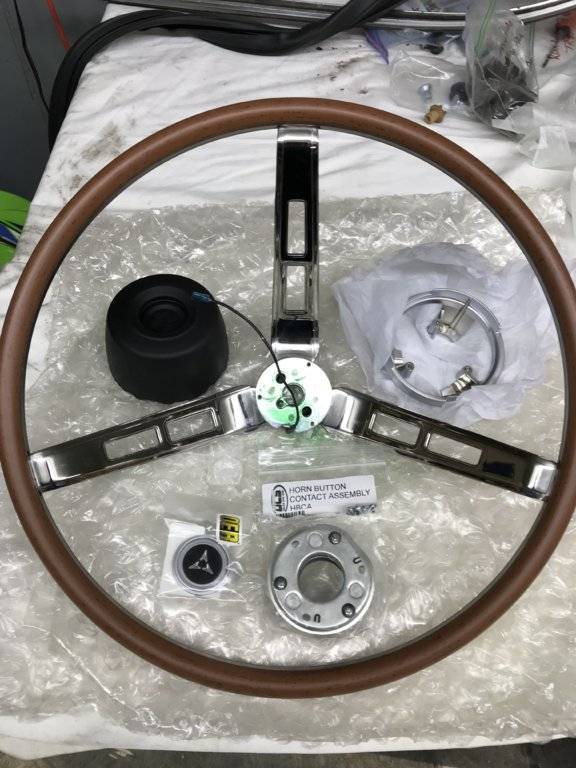

Cleaned up more parts like the rear view mirror, trim pieces and painted more small items. Got all side glass installed this past weekend. Ordered the mass backing carpet from Stock Interiors which should be here the end of the week as well as the door sill plates, door lock ferrules and knobs and front and rear window seals. I still need to order a tinted windshield but it might be a week or two. Noticed Classic Auto had 25% off last week so I got the woodgrain steering wheel kit. Also got the headliner and rear package tray in. The headliner wrinkles will come out after I get all the trim in.

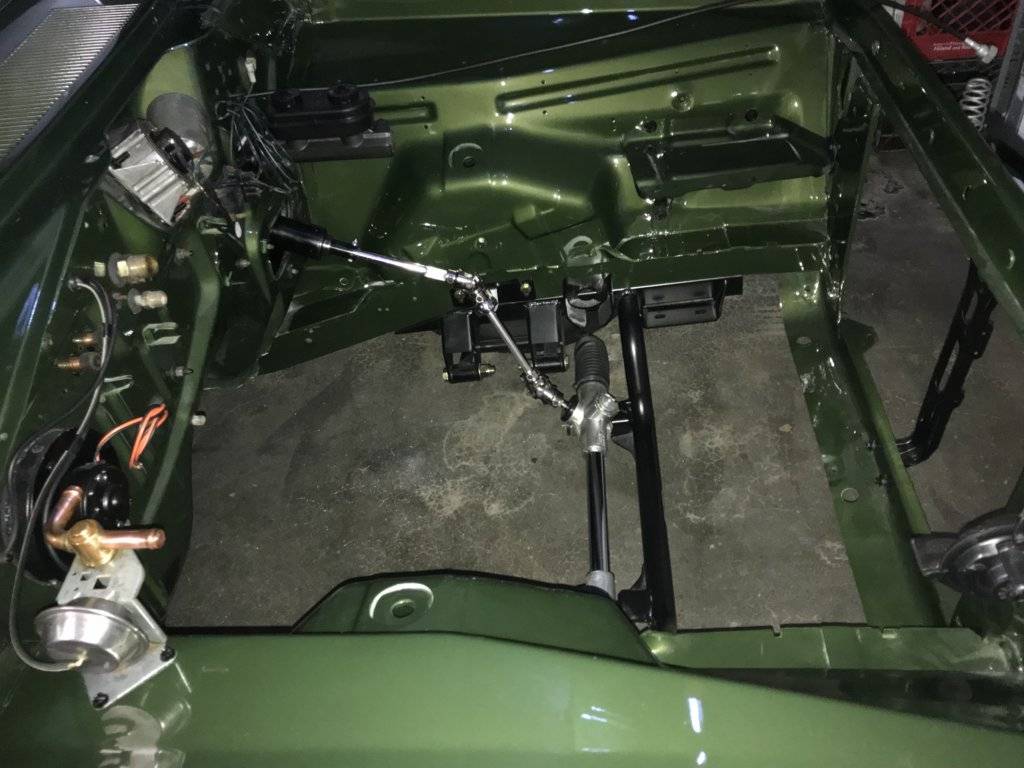

CrOoks, I think it's safe to say that the progress on my Dart (Dottie Rae) is at least a few weeks behind that gorgeous project of yours. Thank you for the motivation too!

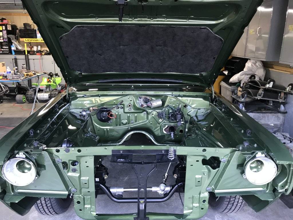

I see you also went with an RMS front suspension. What are you doing with the shock mount locations in the engine compartment? I ask because I see a white substance in there and given the level of detail you've shown so far I have a hard time believing you forgot them. I am planning to weld them up.
I must apologize in advance, as I work through my issues with Dottie I will probably become a pain in the *** with my constant questions!
I actually have the Control Freaks IRS. As for the factory shock mount towers I thought I got enough paint in there to hide everything but I didn't. I might try to air brush some paint in there. My plan is to cut off the shaft of the factory shocks and bolt them in with the factory washers and rubber bushings to make it look like it has shocks installed to give it the factory look from the top side.

Looks like I’m going to have to put a scooped hood on it whereas the top of the carb is flush with the tops of the fenders. I like the Hemi hoods but don’t like how the motor isn’t centered in the opening so I’m not real happy right now. I’ve got an old Torker intake on it without a spacer so I expected it to clear. It could be the difference from a stock kmember to my tubular setup.
