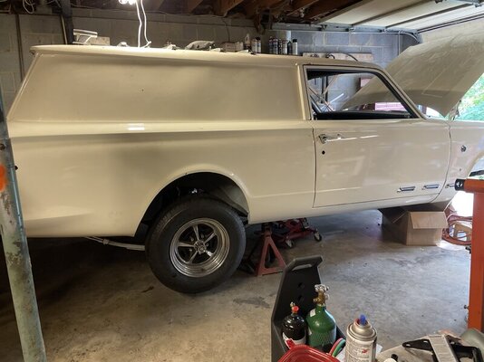

1969 Valiant Slicing
I think maybe you went the wrong direction. Instead of eliminating the b pillar, I think maybe you should have left it intact, and brought the c pillar forward into into the b. This would have left the front seat area intact, and removed the backseat, and left the back quarter window in place. You would have also been able to reuse the front doors without (possibly) modification
the proportions may look better if you threw a 2-3" roof chop into the mix.

Wow! A lot more challenging than my simple wagon conversion from a wagon to a 2 door sedan delivery (or panel wagon)
Well, let me be the first to say that I don't like it.
Not at all.
I can certainly appreciate the skills it takes to fabricate a car like this, but it would be extremely hard to get the proportions right.
Getting the doors to look right will be a nightmare...

interesting project you gonna shorten the truck to put into proportion?, i want to cut up a 1st gen cuda to mustang proportion.
I might shorten the rear. Will make that decision after I get the doors done.

Nice idea. To do any shortening of the rear, I have to get rid of the leaf springs. QA1 makes a
triangulated 4 link to solve that problem. Twelve to fourteen inches can be taken off the rear before it starts taking area from the gas tank. It would be nice to use the stock gas tank.
Nice idea. To do any shorting of the rear, I have to get rid of the leaf springs. QA1 makes a
Oh that’s right. I hadn’t even thought of the leaf springs. I did think about the gas tank though, in that hatchback style I posted, I guess the gas tank would have to be in the hatch area.
