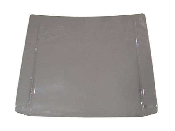

You could always look for a fiberglass hood
Hood, Dodge Dart Swinger, 1970-1972, stock, bolt on, A Body
