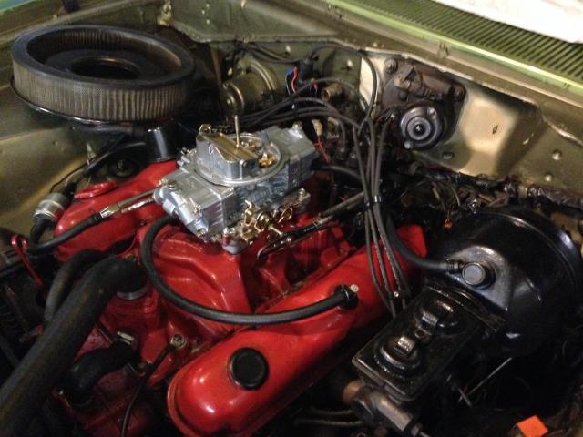

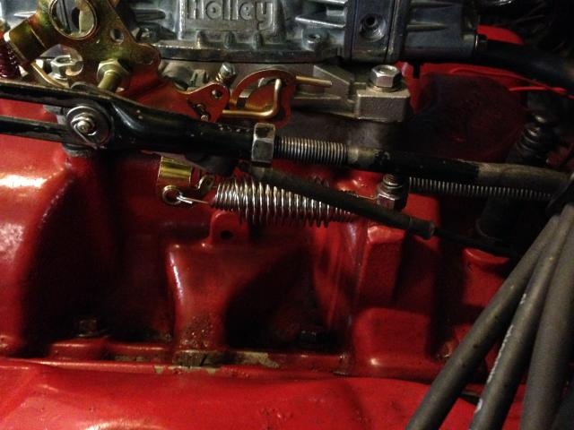

Got some small things done today. Changed out the vacum spring to the softer yellow one in the Holley. Also installed new return springs. Could not drive it though, the weather is to bad over here.

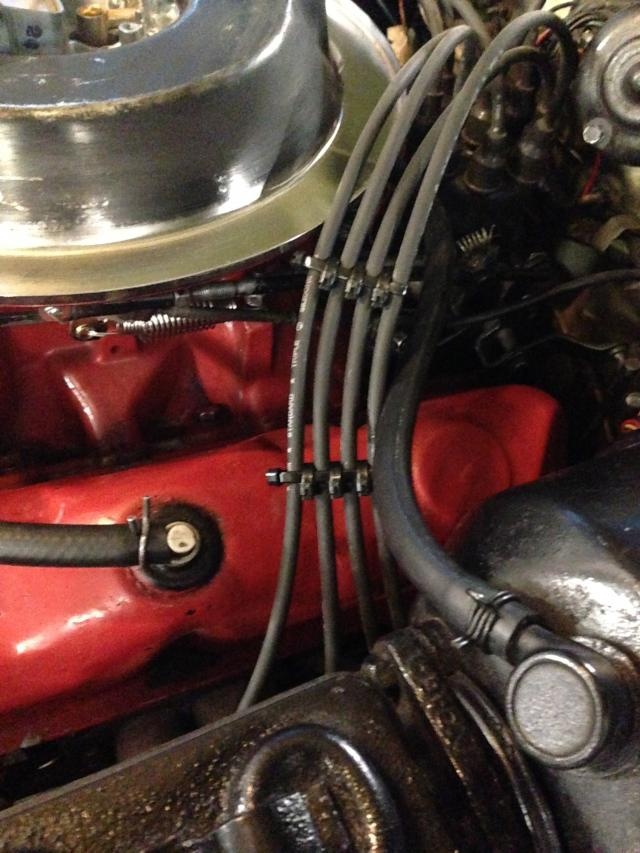

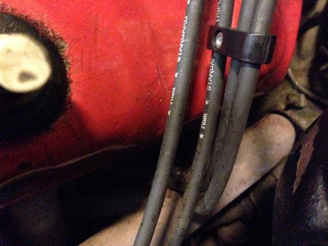

Im arranging my plug wires, it seems no matter how I do it something is crossing something or ending up to close to the headers on the drivers side. Also seems my plugwire holder is a tad to big for my wires cause they tend to slide in it. Any tips, I think I saw some one doing it with zip ties. How do you do that?

It's been nice weather here for a few days so I had a chance to go for a real test drive with the new Holley. I must say I'm really pleased with it. Still only really done a rough tuning and changed to a softer spring for the secondaries. But the response is really crisp and it is already a nice improvement from the Edelbrock 1405 I had on before. Im looking forward driving this thing more this summer :cheers:
Done this ,for years. So much better,than dealing with overpriced aftermarket doodads.

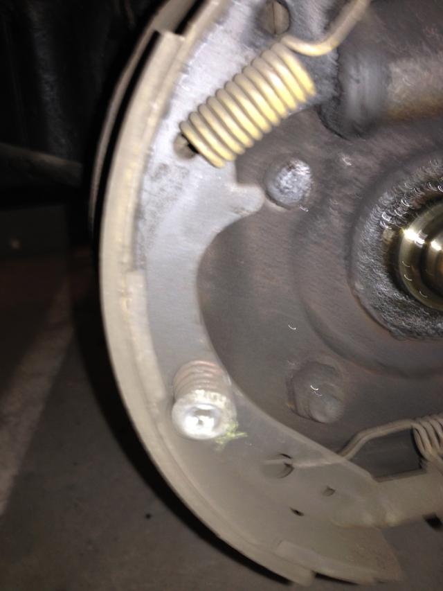

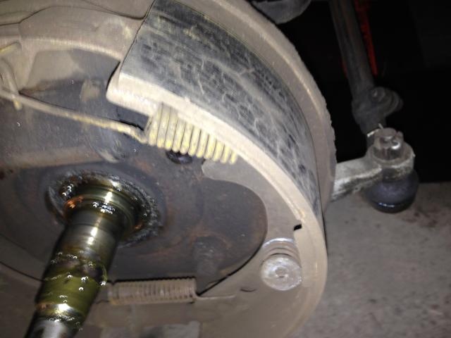

Onto another thing. I have a slight vibration in the steering wheel when I break to stop. I was gonna instal new break shoes on the rear so I pulled the drums up front at the same time. The shoes dont look that bad up front, the primary shoes are a bit more worn. Should I swap them? Do you think the vibration comes from the breaks or something else? I passed inspection last time, only had to swap the idler arm that the header had killed. So there is no play in the steering linkage that I know of.

I also used the zip tie trick to organize my plug wires. Neat trick.
Pictures:
warped drums maybe. shouldnt have anything to do with the shoes.
