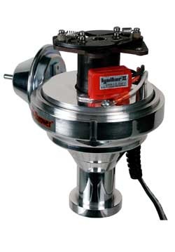

Today I got my new PerTronix Ignitor II Distributor and a spring kit from Holley for the carb.
Distributor, new plugs & new Taylor plugwires.
It's a bigger then previous one, at first I was wondering if it was room for it, but it was no problem.
I had the Pertonix Ignitor in my old one
I indexed the plugs while I was at it.
And here it is installed!
When I took my old distributor of I had the rotor pointing towards cyl 1. When I installed the new one it would not point to cyl 1. I know it dont matter, as long as I have the rotor pointing at tower 1 etc. But I went ahead and moved that kogg under the the dist, I dont know the name of it in english. I just wanted it nice and neat haha. So everything aligned up nice and neat after that. I installed and arranged the plug wires and started it up. Had some missfire so I went over the plug wires and sure enough I had 2 wires mixed up. Started it up again and it went smooth. I did not have a timing gun tonight so I set it roughly by ear just so I could take it for a short testdrive. It seems really peppy and has great response. Looking forward to fine tune everything and try out different springs etc.

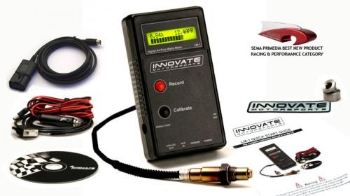

Yesterday a friend helped me to weld a bung for a wideband air fuel ratio gauge (Innovative LM-1). Then we took of my Holley to get a view of the transitions slots, and yes, I was to much into them. So we corrected that and started tuning the idle mixture until we had a satisfactory reading. The transition from idle is now crisp and nice. We took it out with the gauge hooked up, this is the results:
Idle: Perfect
Full throttle: Perfect
Cruising: maybe a little on the rich side
It does however get rich every time I give it gas, so It gets to much fuel from the accelerator pump shot.
Im thinking of going down in size from my 31 nozzle to a 28 (Holley recommends 3 sizes when you make a change), and also going down to 63 on my now 65 primary Jets. Does this sound like a good plan?
