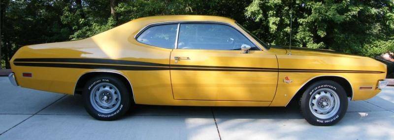

Notice the subtle difference.........
attachment.php
I think the bottom (Hemi) picture looks like a Hemi car should.
Signifigant difference in the stance related to the filled fenderwells.
Coming or going it will have the "attitude".
