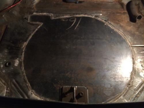

Finished welding sheet metal to trunk in order to make room for fuel cell below. Patched some rusted through spots while I was at it. This won't be a show car just something that looks halfway decent but drives and handles like a dream. Removed the old 7 1/4 rear differential to make room for the 8 3/4. Getting the frame cleaned and have started the process of fabricating brackets to move leaf springs to the inside of the frame allowing more wheel clearance.
