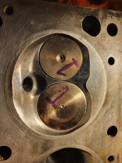

Those chambers do not look like any stock chambers I have ever seen. Milled or not. I have a head that has chambers at 39 CC's. and it does not have that "lump" between the valves opposite the spark plug.
It's casting number is 2206035-3
Casting date is 02 01 6, I don't know how to read that.
Ports look pretty good.
Manley SS valves.

I bet it is less than 38cc
Unless I did something wrong, it's right at 30.
I will redo it tomorrow to be sure.
But looking at the cut, it has very small chamber diameters.
Never thought about that, but I guess as you cut it, it removes material all around the circle.
Maybe it is angle milled?
The dime is totally gone! Bye, Bye Roosevelt, Sir.

2121476-1, 3.60. This is the oldest head I have ever seen, predates Hyper Pak intake by 8422 numbers.
2206035-3, 3.39.
.2 just for argument.
To reduce the chamber volume one cc., mill the head .0063".
If the race head was at 60 CC and it's now at 30 CC then the cut would have been .189.
So it just might be cut that much.
That is a lot of cut.
I dont think I ever milled more than 0.120" off a head.
Mine I am running on Vixen is 34CCs and has been cut about .175". It still has the "dime" opposite the spark plug, so I surmise the head above has been angle milled a LOT.
The 2206035 head off of the '62 170 I have here looks like it would take a bonafide .200" to look like that.
I didn't measure both side, I will tomorrow to see if it's an angle mill.
Head bolt bosses are not milled, so I doubt it's angle milled.
It was on a Valiant that ran in the 11's so it's got some provenance.
