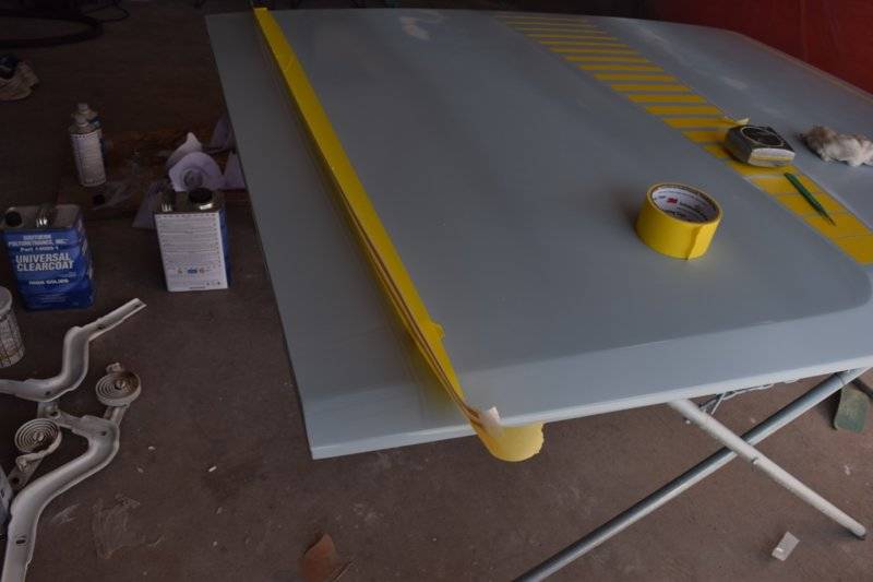

After a total disaster with the Automotive Arts Motobase I learned that I have to shoot it with VERY high pressure to flash off a lot of the reducer before it hits the panel or it will attack the dry base already down and make it lift and crackle.... We finally have a perfect base ready for clear.... Kaelyn also put on the sandblasting hood and blasted the front components and I shot them with epoxy and base this afternoon.... Now the big question, after this long battle do we risk putting the decals under the clear and have a risk of screwing it up again......
Also have the bolts ready for epoxy and base in the morning will we prepare for the ladder strip mask and black hood stripe..
We are also trying to work the rust out of the hinge springs with vinegar in a spray bottle. Working it in spraying while working the spring. My forearms are sore those springs are stiff.... It is getting quieter and less creaky...
Ready for 4 coats of Universal Clear tomorrow!
Ain't no way, no how that I would clear over vinyl stripes. I think it's just askin for trouble. The black stripes are going to expand and contract at a greater rate than the blue paint, so I see that turning into a spider web cracked up mess. If you just put the stripes on top of the clear, it will be easy to replace a section of stripe, should the need ever arise. If the hood springs are still squawkin after you get them painted, let them dry good, and pack some clear silicone grease in the spring. A friend of mine did that to some Duster hood hinges, and they quietened down.
Ok 5 coats SPI Universal Clear and we are almost done... I blew the gun settings on the tail panel and blasted it.... Run city.... Need to sand back out and redo the tail panel..... The other panels can all be cut and buffed next week!

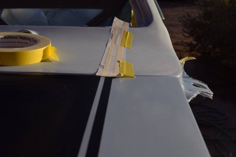

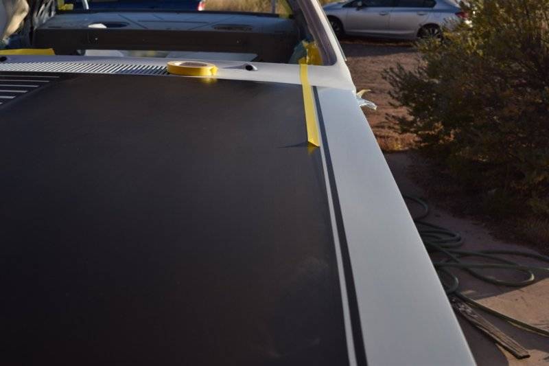

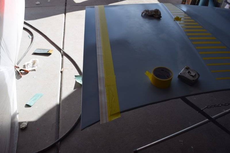

Got really brave and yes the Graphic Express mask for the Twister hood do work well. Thanks to @John_Lemon for warning me they are tricky so I pull all the stops...
First trim the ladder so it is close to the mask vinyl so it is easier to center. Then run a "hinge" of tape so you can fold it back and remove the backing. Then care fully flip it back down and move from the middle out pressing it down. Peal the upper backing at a 45 degree angle and folded flat pulling away from the mask.
I then gave it a quick spray of clear to seal the edges so the black did not run under the mask vinyl. I mixed some SPI black base with the Motobase reducer because I was out of SPI. Barry gave me the green light to do this last week. Guess what.. The damn thing crazed again... There is something wrong with the Motobase reducer I got. Finally I battled it and got it down. I went to wipe up some adhesive and STUPIDLY picked up the Acetone and not the Wax and Grease Remover.... Total destroyed a corner on of the the ladders.... Time to walk away..... It can be fixed since I am not done with other parts nothing lost but an hours of time....

I slight bow on the cowl?
What is your base body color going to be, I thought you were doing B5?
He painted it B1 "Blue Sky".
And yeah, that mask on the cowl looks crooked or something. Could just be the camera though.
