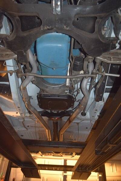

Oil change and an underbody wash for a 5am breakfast!

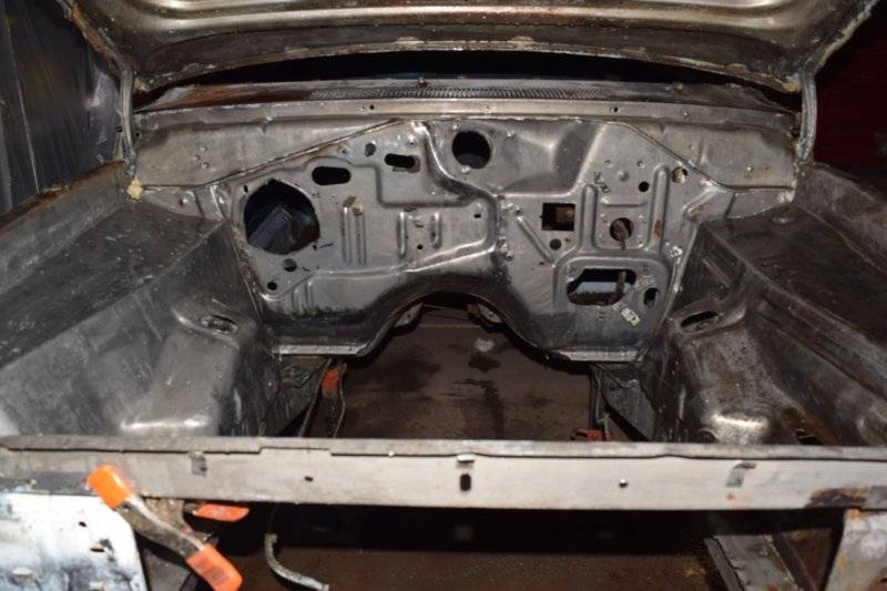

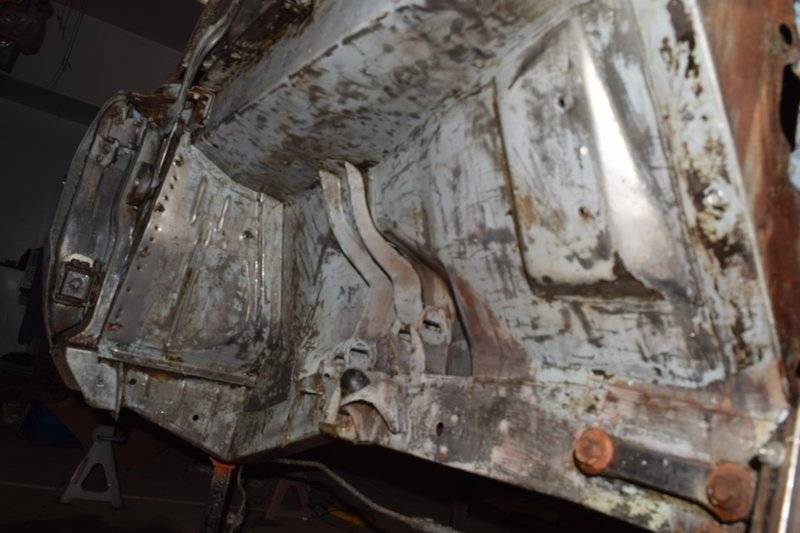

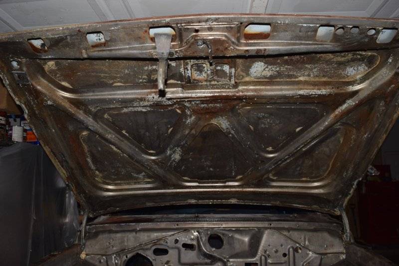

Gallon of Aircraft Stripper and a few hours with a the daughter and wire brushes we are getting closer to having the front clip completely stripped. This effort opens the door to weld in the left inner fender now (just setting in there right now)...
View attachment 1715203415 View attachment 1715203416 View attachment 1715203417

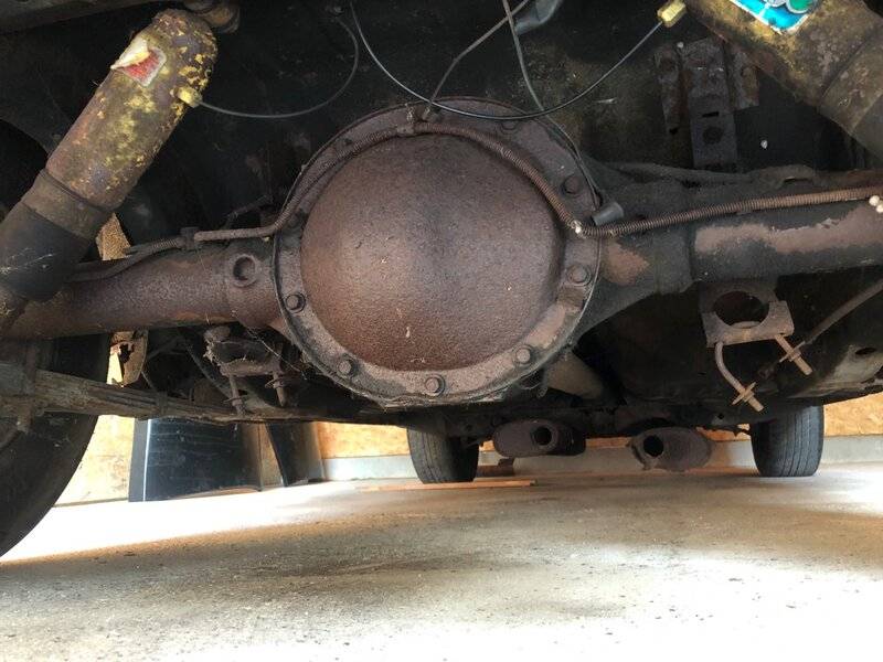

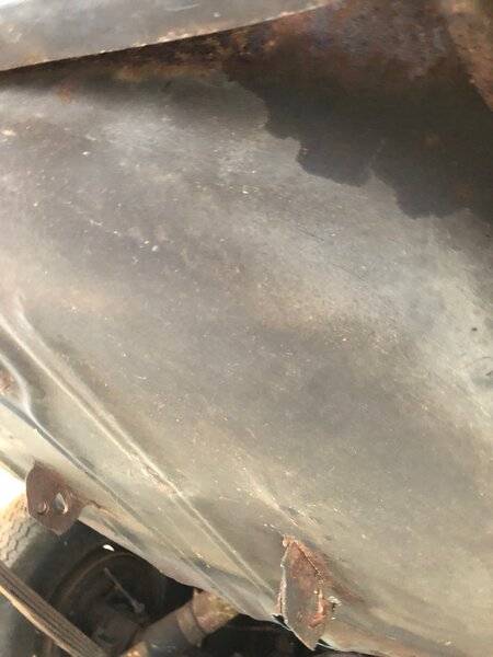

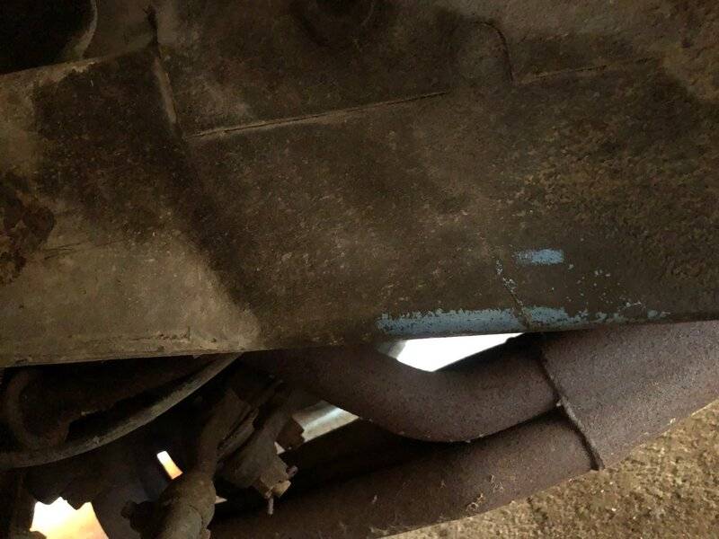

Jim question after a good cleaning do you think the stripper would work on undercarriage? I was also told Off heavy duty oven. What I will be working with attached.
I agree. ^^ Good brand of OvenOff does good job for grease and grime. Like said, needle scaler works well for undercoat and is cheap enough. A lot can be done at the car wash with the wand, with car sitting on the trailer.
Yeah I saw a needle scaler I don't need the most expensive stuff just tools that work. I thought harbor freight had it. I also gotta get the punch/flange tool and a small mig. I have 220 ran and was looking at 120volt titanium mig with or without gas. Won't be doing very many panels. All the documentation helps out I did this a long time ago same tools except the mig. We used a body panel spot welder with flange and alot of mud. Thinking no flange and seam is going to look alot better and less mud

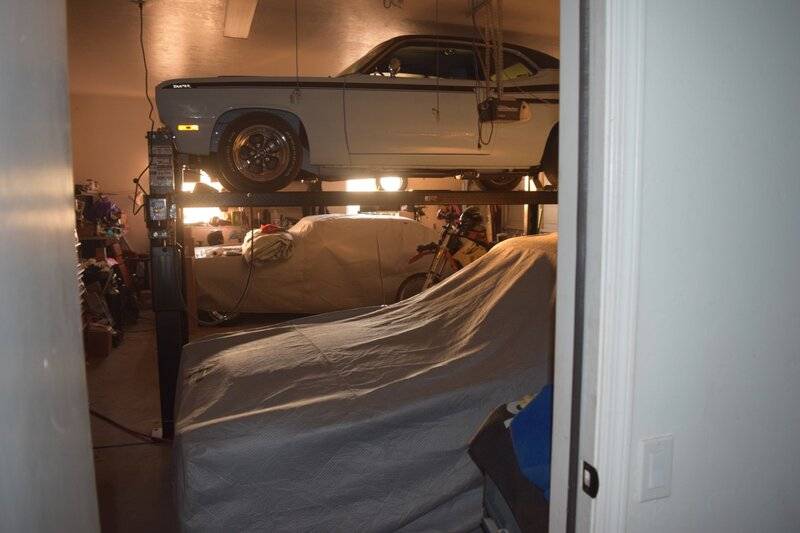

Lot of cleaning three cars. Will number four be it?
I was just bitching about the same thing! I cleaned up the garage so we could have a "cleaning stall" and the Valiant out of the way. We just washed the Duster and got the cover on it finally. Something has to give past 4!
