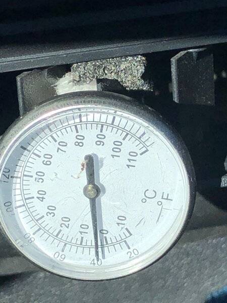

This project was 2 years in the making but finally solved and finally DONE. Brrrrrr.
Kaelyn and her sister took it for a spin.... they shut the AC off half way through their cruise..... they were freezing. Mission successful.

You're using the original condenser? Is it serpentine, or tube and fin? What are the pressures? I'm just amazed, because I haven't seen many R-134a retros using the stock tube and fin condensers that worked that well and didn't have sky-high discharge pressure.
Original condenser. The pressures on this 85F day were about 170 high and the low was really low, around 20, but it was cooling well.
Interesting. Again, 85°F isn't hot, but those pressures seem low. Especially he discharge pressure. The system sounds undercharged to me. When running at around 1500RPM, does the sight glass ever clear up?
