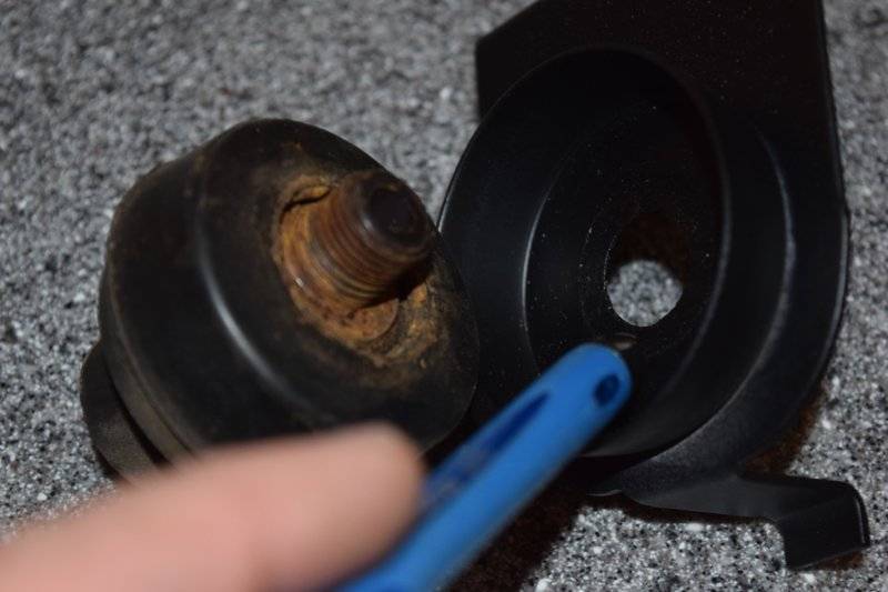

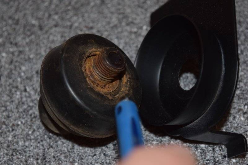

Washer Foot Pump. The bonding between the bulb and plate with the fitting has dried out and failed. I found a NOS on on eBay for a fair price it will be here Monday.

WTF: I got the NOS foot pump. The center piece I took out is SUPPOSE to be free from the rubber and come out..... How does this damn thing seal and work? Can anyone explain to me how this system works....
I dunno for sure. I have same setup on my '69 GTS and it is pretty "Mickey Mouse". Lots and lots of pumping for a very weak spray. Not good. I think if you really plan on using those washers much I'd get the conversion to an electric pump!
I figured it out. The seal is made between the bladder and the mounting bracket not the plate and bladder. Once we start putting it back together I will explain better. We will see how it works. We got the electric with the Dart so I have the switch to make it work.

The foot operated washer system.....
The center plastic should not be bonded to the rubber bladder so the seal is actually the plastic disk pulling back on the rubber bladder and pinching it to the metal bracket. That says the bracket around the hole is always submerged in washer fluid in that that area...
Now on the other side there is a flat rubber gasket so the fluid does not leak out around the threads of the plastic plate's nipple.
Guess what the size of that is? Almost the exact size of a garden hose gasket! I ordered some round ones from Amazon for the garden hose and to try on this...
You can see the nipple adapter has a flat back side that pinches the gasket to the bracket and the adapter. The small nipple has a small bearing in it to make a really cheap check valve... The direction seems backwards to me but I will learn more once we get it installed and try to operate it.
