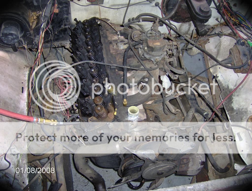

I plan to pull the head today, before doing so I thought it best that I run some REAL air into the cylinders. Again was not sure where it was leaking, sounded like exhaust though cause putting my head over to the drivers side it sounded like air was traveling down the pipe.
I ripped off what was left of the dangling muffler and put a piece of paper in front of the pipe, sure enough air was just pouring out the pipe.
This was on cylinder #2
I tried then cylinder #1 and as soon as I put the air to it the engine spun just a bit, this is the cylinder that I was able to get a reading of 30 pounds on at one point after fiddling with it and then back to a zero reading a bit later.
Again air is coming out the exhaust, not nearly as violently.
I believe this cylinder at this point is prob. holding some air/compression but again there is an issue with exhaust valve leaking.

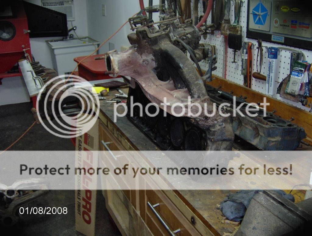

I have all the stuff out of the way and thought Id add a pict.
Here is where I am at # 2 chamber.
What grit lapping compound do you guys think I will need to fix this :)
I plan to remove the valve, I have been told that I can remove the valves and as long as I am either lapping them or having machine work done/new seats I do not have to worry about mixing them up.
At this point I see no damage to the valve seat, I am still hoping that I can put a spare valve in there, lap all of them and that will be enough to have it run decent again.
I see no damage at this point to the cylinder walls ( other than a light pitting at the very top of piston/cylinder travel ) but I need to do a closer inspection.
OK, you got a badly burned exhaust valve. You can get ANY old exhaust valve you got laying around (or a new one) and lap it in. I found the easierst way to quickly cut a valve is to insert valve in head and chuck an electric drill to the shank. usae a sharpy to mark valve seat and valve lip, apply lapping compound and spin valve at med speed while making short light contacts with the valve seat, sort of an up and down motion. Reverse the drill every few seconds. You just want to cut the crud on the seat with the valve angle. Once you see the sharpy uniforrmly scrubbed, you can remove all traces of lapping compound and reassemble springs. I use a steel wool pad to get surface crud off seat prior to all this. A new valve will have proper angle already on it. An old valve may have a cupped lip, not good. Use a good core or new valve, they are cheap, and a machine shop will cut a bare valve for about $1-2 a piece.

Someone had been into this thing before, permatex or some sort of gasket sealer on the head gasket.
Noticeable enough ridge at the top of the cylinder wall but I have felt worst. A couple of small areas at the top of the cylinders where I am guessing it sat for so long and condensation got into the cylinder causing a bit of rust/pitting but as far as I can see it is at the very top above compression ring.
Dang that thing is cleaner than I expected. The small rust can be gotten out with some very mild abrasvie action. Ridge should be OK as long as not new bearings.
