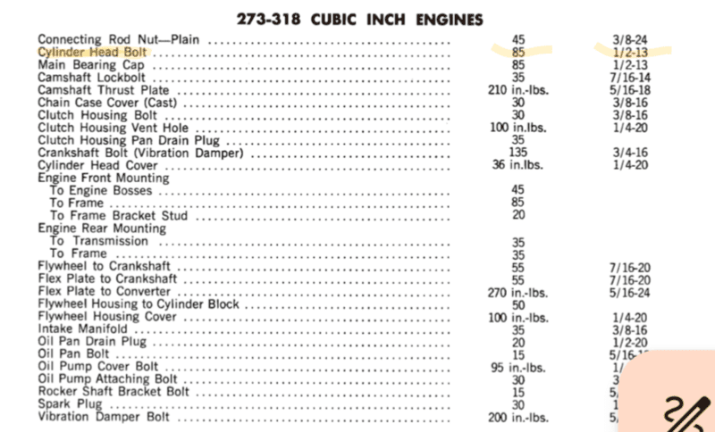

chilton 273 318 head torque spec says 85 ft lbs in low compression engines but does not mention what it would be for the commando ....just says 273 318 .. it says the 340 is 95 ft lbs. wouldn't you think the commando with 10.5 compression will be torqued at 95 ft lbs also like the 340 ?.

two different compression engines.. do you really think 85ft lbs is going to hold back a 10.5 compression engine that spins 6000 rpms ? 340's were 10 to one compression and they have 95 ft lbs torque. what gives? can't believe everything you read .
Bolt torque is based on bolt size, type of bolt thread pitch, metallurgy of the bolt and block, and the amount of allowable stretch.
If you over torque the bolts they are more likely to break.
To me the engineers who designed the parts would be a better source of info.
10 more lbft may be allowed due to better head bolts?

I have new arp bolts to use this time around ... arp recommends 100 ft lbs and there special lube. I'll be using a composite gasket 318 with a small fire ring also . that mr gasket 1121 has such a large bore ... it's almost to the edge of the valley ... with a 3/8" gap all the way around the fire ring to the edge of bore. also I noticed when removing the head that black coating on the 1121 gaskets released a film that had plugged a few of the water jackets. 1121 suck.
273 calls for 85 pnds torque, i found if you torque above that, it distorts the block deck. my 340 i use 80 # torque , also i use moly lube on bolts, also i torque in steps, 40, 50 50 70, 80. i ran into this issue long time ago.. i have customer, runs a 340 @ 10.65 cr, i torque heads at 85, with moly lube, never has had a gasket problem, also i use felpro 1008 gasket. just food for thought.

arp bolts says to torque there bolts to 100 ft lbs.. Is that ok to do ?
shop manual says to torque 340's to 95 ft lbs.. why is it it doesn't warp 340 blocks with no issues with gaskets, heads or blocks? 273 is basically same block with smaller bore.
all i wrote, i in regards of torque is from personal experience, i have always used moly lube on my head bolts and main bolts, by using moly lube , you will have more clamping pressure without distortion. i used on my 273 and my 340,.i know arp wants 100, lbs, you will pull block deck up creating a deck with low places and high places. also gasket seal problems. first time i torqued my 340 block at 95, it bell mouthed the top of the bores, by .006 i retorqued it at 85 had no bell mouthing of bores. my 273 was 11.1 cr, my 340 is 9 to 1, cr. i run stock eliminator with it. just food for thought,
Same design but not the same block
It is my understanding that the drag that a dry bolt thread provides is calculated I to the torque spec.
The luse allows the bolt to spin easier and now the same amount of torque is over tightening the bolt
Somewhere I recall seeing lubed spec at 50 (just a number) and dry is 75 ( just a number)
Torque on a fastener cannot be calculated. It is an attempt to get a desired stretch on a blind fastener. It is found by trial and error, and is also dependent on the lubrication. See posts #14 and #19 and take it to the bank. Perfacar also is giving you which head gasket to use. The most accurate way to "stretch" a fastener, say a rod bolt is to measure before and after torquing to achieve the desired range of stretch.
