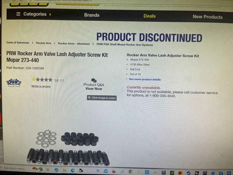

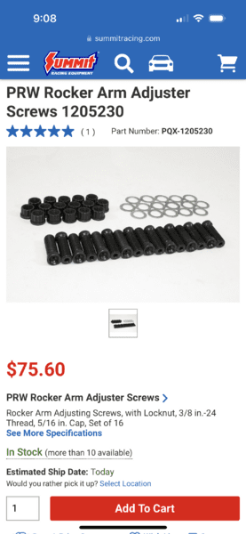

Thank you. So I just learned that these will not fit. Went to PRW website. These are 7/16-20 for Aluminum rockers and Mopar Steel rockers use is 3/8-24 and I confirmed this by measuring mine. I’ll have to call them to see if they make the 3/8-24. Jegs site didn’t even out they type of thread spec on their page.
Yup, just like I mentioned. You need 3/8 - 24 with 5/16 ball cups. That is of course, as long as you have stock pushrods, but that's not been disclosed, so make sure of the size of your pushrod cups.
PRW is possibly only selling these per unit as replacements. Looks like this 273 set up is getting hard to use.
here's the easy button if your call to PRW doesn't pan out:
note, that's a crane part number... lookie here:
so you may be able to snoop around a bit an unearth some on a dusty shelf or ebay
or you could start here and DIY the rest:
