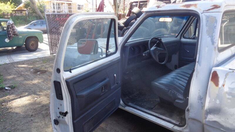

man , i watched that video on the 5.7 and 8spd trans in the ramcharger , wow clean setup , makes me think what a great smogger swap . here in california every two years 1976 and newer must pass smog emissions every two years for life as i said . and this would be ideal for my shop truck commuter . out with that 318 injected pup and in with a newer hemi . hell i might even do the bodywork n paint it , i'm modifing up a set of old school vintage 200s's for it now .
