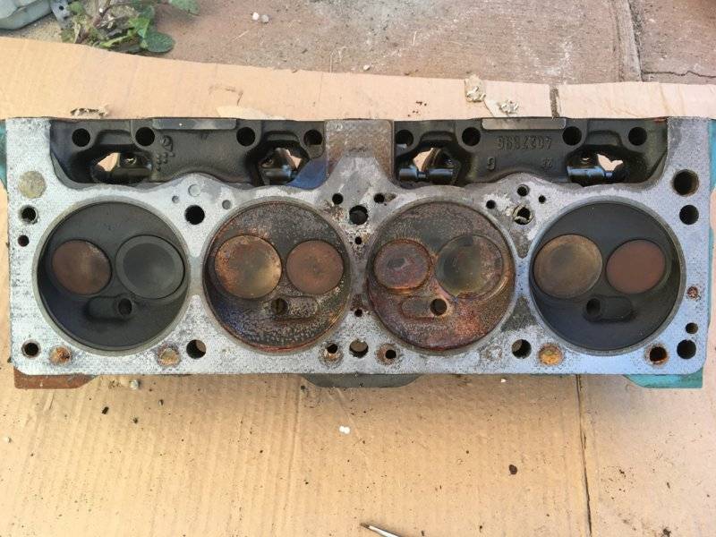

are you going to rebuild the heads? I suggest k line the guides then multiangle valve job then U hand blend the bowl

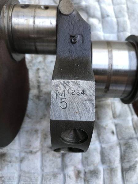

better have that crank checked but it might just polish

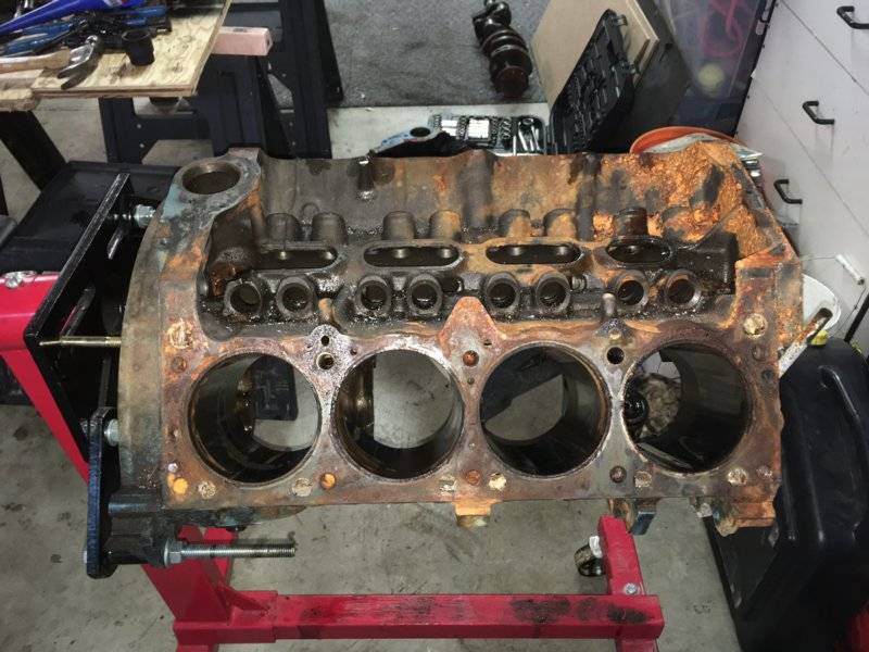

looks like some rust but it might clean up at .020

Yeah I’m definitely gonna rebuild the heads and I wanted to have some work done but I wasn’t sure what I needed, I’ll have the crank checked for sure, thank you!

I did this 318/360heads last summer and have a thread about it but definitely the same culprits will probably chime in here. But anyways I cut fifty thousands off the heads. If I did over again I would have probably cut more off and still been able to make the intake manifold fit without any problems. You get the bigger valves but you have to shave the head down to bring your compression back down. On my Stroker motor of course I didn't have to do this it was already heavy on compression.

If you have to spend a little bit of money it's okay to do it on the heads. People start to argue that by the time your five or six hundred dollars into doing your heads which unfortunately it could get up to about three or four at least you could start to be on your way to having some Edelbrock heads, but I still haven't been able to afford them yet.

If you buy 10.5 compression pistons for the 318 and throw on the 360 heads, you will end up around 9.2 compression and benefit from the larger ports and also have 2.02" intake valves installed...

Work on the heads for best power return on money spent after the short block is done.

Use the 360 heads, have a valve job done, no need to go 2.02 intakes, 1.88, 1.6 valves are plenty, if guides are loose have them knurled, cost less than new guides, has about a 40,000 mile life span, unless you intend to have car longer than it will take you to roll up 40,000 miles, then do guides, cast iron is less expensive. Have heads milled to reduce chamber volume to 60-62 cc's range, again compression building. Just about any dual plane intake will do, even factory cast iron, cam shaft there are dozens to choose from, pick the one that complements how you are gonna drive the car , error to the side of small.

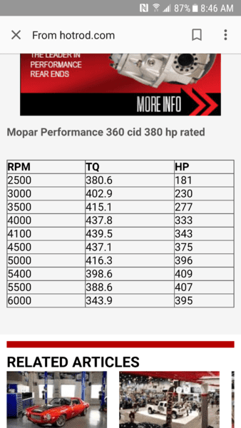

Build for the gear, with 2.94 gears your not gonna spend much time above 4000 rpm.
A similar built 360 an optimal gear would be in the 4.10-4.56 range and acceptable compromise would be 3.55. A 318 needs about two steps higher (0.5:1) to have similar performance. To me 3.91 should be the least gear for any decent cammed 318 or accept your leaving a lot of power unused.
Thats a dyno of a 360 380hp create engine.
From 5000-6000 rpm it basically making the top power of 400 hp. But at 3800 rpm its down about 100 hp and by 2800 rpm its down another 100 hp making only half.
Less gearing gives you less rpm per mph.
Giving you less hp at any given mph to use to accelerate your car. Better to cam for more under 2000 rpm power even at the expense of 4500 rpm plus power. Especially if your not spending any real time up there.
Basically what Im saying its not worth trading 25-50 hp at the bottom for 25-50 hp at the top.
I probably wouldn't go bigger than comp xe262hl or similar with those gears.
With 360 heads and decent cr should put you at 1 hp per cid around 5000 rpm and 1.15 lbs-ft per cid a 1000-1500 rpm lower.
Could also run deeper 1st and 2nd gear. Will make stop light to stop light action a little more fun.
