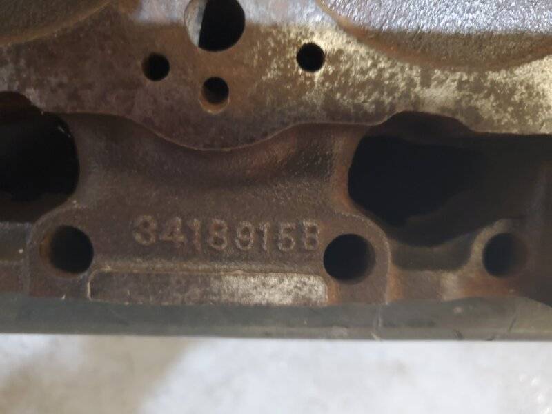

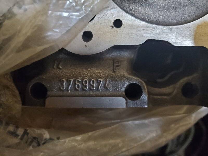

The 340 would need the chambers to be 60-62cc to be a true 10.5 compression.
I thought the op was getting a rebuild and wanted to know why the head cc number was needed.
The intent was to figure out what pistons to use with the heads I intended to use. I have found out that the 202 heads are 58cc. Now I don't know whether to use those heads or the 1.88 valve 360 heads.
If they've been milled that far, I hope they also milled the intake face of the head so that you don't have manifold fitment problems. Once the heads are on the engine unless you take them off, you'll have to Mill the intake manifold for it to fit. If they're a good machine shop they would have all your parts though and machine and mock assemble to make sure it all fits.
Here's what I have for LA head spec's up to '86 or so, I'd appreciate it if someone could fill in up to the end of the pre-Magnum engines.
LA Small Block Cylinder Head Casting Numbers and Spec's
Through 1986 (From How to Rebuild Your Small-Block MOPAR
by Dob Taylor & Larry Hofer HPBooks 1987):
Engine ---- Year ------ Casting - Intake/Exhaust - CC
273 -------- 64-65 --- 2465315 - 1.78"/1.50" - 57
273 -------- 66 ------- 2536178 - 1.78"/1.50" - 57
273/318 -- 67 ------- 2658920 - 1.78"/1.50" - 57
273/318 -- 68-74 --- 2843675 - 1.78"/1.50" - 60 '69 last year for 273
318 -------- 75-83 --- 3769973 - 1.78"/1.50" - 63
318 -------- 77-86 --- 4027163 - 1.78"/1.50" - 63
318 -------- 77-84 --- 4027593 - 1.78"/1.50" - 63
318 FstBrn 85-86 --- 4323302 - 1.78"/1.50" - 62.6
318 Police 83-86 --- 4323345 - 1.88"/1.60" - 75.1
340 -------- 68-71 --- 2531894 - 2.02"/1.60" - 63
340 TA ---- 70 ------- 3418915 - 2.02"/1.60" - 65
340 -------- 72 ------- 3418915 - 1.88"/1.60" - 65
340 -------- 73 ------- 3671587 - 1.88"/1.60" - 65
360 -------- 71-72 --- 3418915 - 1.88"/1.60" - 65
360 -------- 73-74 --- 3671587 - 1.88"/1.60" - 65
360 -------- 75-76 --- 3769974 - 1.88"/1.60" - 65
360 -------- 76 ------- 3671587 - 1.88"/1.60" - 65
360 -------- 77-86 --- 4027596 - 1.88"/1.60" - 65
360 -------- 77-86 --- 4021051 - 1.88"/1.60" - 65
Note: of the unmolested heads that I've had CC'd they came in between 2 and 5 cc over spec, except for one set of ...302s which were 0.5cc under spec before chamber work and milling.

From my experience those are NHRA minimum specs. I can tell you that it took .040 off "J" heads and "920" 273 heads to get down to those numbers. Also see Post#40 about milling the intake face. I also milled the intake face .038 on both the "920 and "J" heads, like thew book says and had no fitment problems.
Yeah cause it AIN'T gonna fit with the heads milled down that far.

Most all those numbers maybe except for the 273 are completely erroneous. I don't know why people publish stuff like that.
Those are the spec's the factory published, I guess they didn't blueprint the heads before they went out the door. Anyone building for performance, however probably should check/correct them.
They also published the 68-71 340s at 10.5:1 compression. LOL
