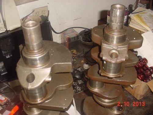

Good point about the TDC mark on earlier balancers. However OEM cranks were forged in 1971 and I believe started to go cast late in '72. Cast will have a thin parting line on the casting and sharp corners on the counterweights. Forged has about a 5/16"+ wide machined parting line with rounded counterweights.
I took it apart and researched it then and your right about the years and the identifying marks, I'm just wondering if the earlier forged crank balancer can be used on the later forged cranks ?
