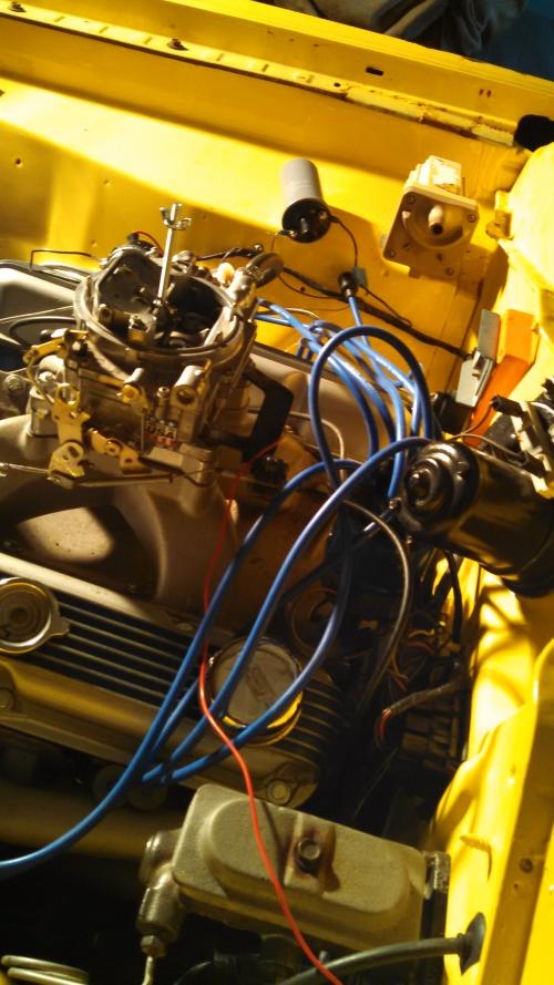

attachment.php
This is not a 383. It's a smallblock.
Thank you for your help. I have someone coming today to look at it. He used to race Mopars for a living. So hopefully he can see what it is that is causing me the issues. He said that if he can't figure it out in my garage we may have to tow it to his it may be more extensive than we think. I have worked on this car for a year now off and on and it is time to call in a professional.
Sorry to hear you haven't gotten this resolved. After talking with you, it's very possible it's an internal problem such as cam timing etc. Post back when ya find out eh? We'd like to hear what it turned out.
Ok this is where we are guys. We got it started. My timing was a little off I was 10 degrees off but that was not causing my issues. We were not getting fuel to the carb so we pulled the fuel pump. Pump was working good. We pulled the fuel line to the carb that was working good too. So we poured a little gas directly into the carb cranked on it a bit fired up then shot up in the air! There was a clog somewhere. So then we started it again would not start. Checked for spark with the key in Run position no spark. Cranked it over with the the ignition we had spark. So the ballast resistor was the problem Switched that out got spark with the key in the Run position. So my mechanic told me to drain the oil even though the car has never been driven and put new "break in oil" in with the zinc additive. Then after I do that we will break the cam in. I am so stoked. I think I might actually get behind the wheel soon and actually drive this beast for the first time in a year!

Ok so this is where I am at. I bought a TDC Indicator and put it in the #1 spark plug hand cranked the engine until it popped out I was then at -10 on the balancer. I had no idea what that means so I dropped the dist back in. Nothing. I ended up leaving the key in the run position ooopppps! Im recharging right now. In the meantime I took the cap off of the dist and looked to see where the rotor cap was facing it was not pointed @ #1 so I left it out hand crancked the engine until I knew it was in position to keep the rotor cap where I wanted which is pointed at #1. Now I have to go home and hopefully start it up since the battery is recharged. I gotta get this done! Im so bummed.
