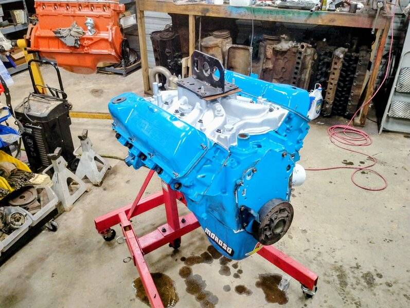

Still movin along on Gladys' motor. I may be slow, but I get it done.
