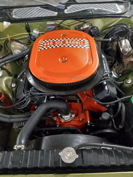

I recently did a swap in my 71 satellite Sebring Plus. 318, 904 trans to 440, 727 trans. 20-20 hindsight I would have done stroker to 390 with the 318. All the different brackets, headers, trans lines, etc. Really blew the budget. Can't beat the wow factor of a 440 6BBL.
Yeah 440 Sixpack is surely eye catching.... but you probably could have built the whole 390 for the cost of the sixpack.
