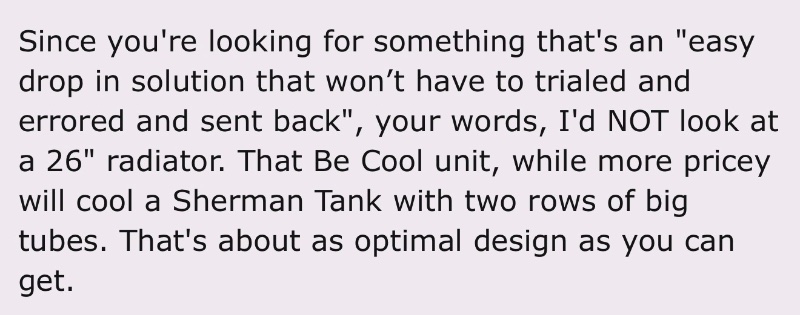

Since you're looking for something that's an "easy drop in solution that won’t have to trialed and errored and sent back", your words, I'd NOT look at a 26" radiator. That Be Cool unit, while more pricey will cool a Sherman Tank with two rows of big tubes. That's about as optimal design as you can get.

The Be Cool unit with the big tubes is definitely on the radar. If Champion is not desired I have no problem skipping over to Be Cool. Are you saying not to grab the 26? Reasons?
What you wrote up top in the middle would’ve been heck of a better way to start. Apologies if I hit a nerve. I’ve run into all types of people that live on a high horses and dole out information and slights. You’re a pretty darn active member here and folks definitely look up to you and the knowledge you have. Me I like to save a buck, modify stuff and call it my own. While at the same time having good conversations with my mopar friends. This whole thread was based on a Champion referral to those that used this brand. Now that tons of options have been laid out and none for Champion I’ll call Be Cool and get a tech to chime in. I like the Sherman Tank reference.

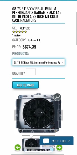

I THINK they sell a god product IF IT'LL FIT. But good luck with service after the sale.Ok as I look over at Cold Case I found this option. It’s a single fan though. Inlet and outlet are where they need to be. No mention on pipe thickness. Small amp draw. That could be concerning. But a nice ce small package.
Price is decent and the wife isn’t looking. at me.
68-73 B,C,E Body 16x22 Manual Aluminum Performance Radiator
