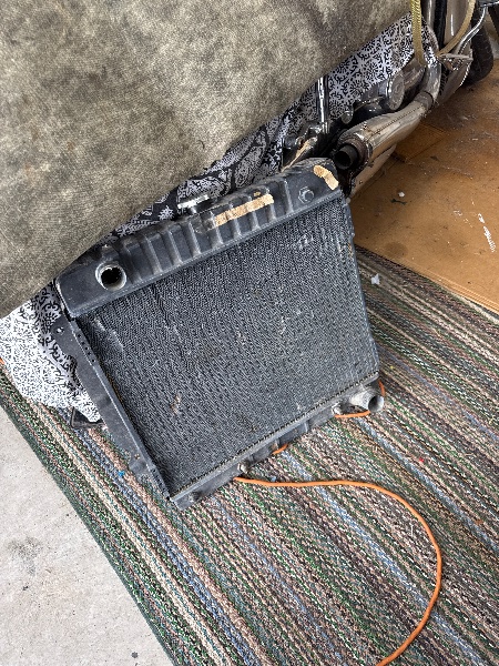

I have this from my 72 A body 340, dm me if interested, I will take it to my radiator guy to make sure it is good.. it will slide right into your car and has the trans cooler built in
Thanks for the offer. The inlet and outlet are reversed for my application. Water pump is on the drivers side. Appreciate it though.
