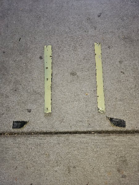

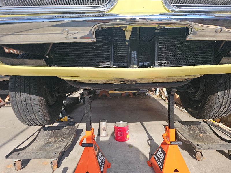

On my '68 Barracuda, which was originally a Slant 6 car, I cut both sides out of the opening and had the bottom hose outlet moved over to fit a US Radiator I had been using effectively with a 440 in my E-Body to get it to work with the 5.9 Magnum I'm running. The fans are the max CFM Dual Spal 12" fans with their shroud and controller.
The black pieces in the picture are from the lower grill opening that I cut to better fit a pair of transmission plate coolers.

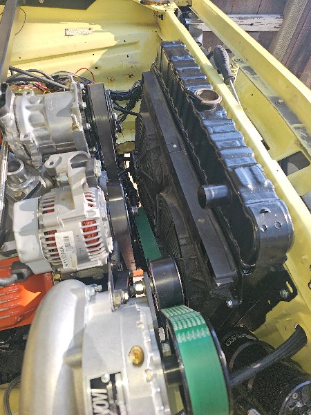

I'm running the MP viscous fan and a reproduction fan shroud. I'm hoping that I can make the shroud work with the ColdCase radiator.
I'll be curious to see how much clearance you end up with between the fan clutch and radiator. I wanted to run one of those Cold Case radiator in my '68, but there wasn't enough room. I ended up going with a Champion unit and still only have about 5/16" between the fan clutch and radiator core.
I know of which you speak. I had a 3 core Champion in a 67 and was struggling to make their crappy fans work. There was definitely not enough room to run the factory fan. If I am tight for space, Hayden makes a low profile clutch that should help.
I haven't even pulled the old engine yet, so it will be a while before I get to installing the cooling system.
That's the fan clutch I've got. It's actually one of their prototypes from when they developed that shorter HD clutch. It's still really tight. It doesn't help that the companies making these aftermarket aluminum radiators don't weld the brackets such that the radiator core is flush with the core support. They're losing some valuable space right there. Keep us posted!
That's the reason I'm using the Spal fans. There's no room for the superior factory fans.
