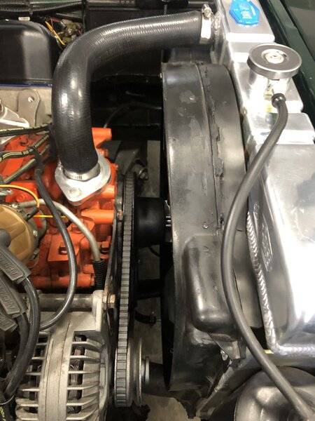

440 overheating at idle
You make no mention of "how hot" hot is. That said, over heating at idle is an air flow problem. Either not enough fan or it's not installed correctly. With no pictures, it's a guess at best.

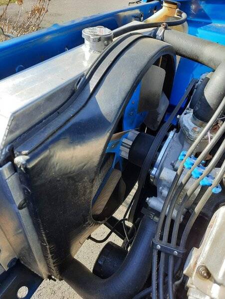

With the deep fan setup you can try running without the shroud.
In that configuration the shroud can be blocking more air flow than it is helping.

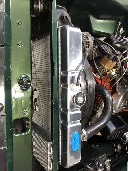

Seal the top of the radiator support to the radiator. Also make sure there is not a path around the sides of the rad for the air to escape. Make the air go through the rad.
You have a better radiator and taller than mine. I have a homemade shroud tiny 16" piece of crap fan and it still does ok. My blades still need to come out some more but I'm going to enlarge my opening to fit a bigger fan and get an 1" thinner spacer.

Thank you. The original setup was a clutch fan, original rad. I thought the car ran a bit hotter than I was comfortable (looking at the car’s gauge). Over the winter I decided to upgrade the entire system (aftermarket gauge included) and the fan was recommended by the Performance Parts dealer who dealt with a lot of racing applications. I can’t say that I am completely comfortable with a plastic fan (although they said they are good to 8000rpm), but it pulls a ton of air. My plan is to continue to tweak the system to get it where I am comfortable, and then look at a fan change to metal. After all the responses (A-Body brotherhood is awesome) I am focused on fan placement, and timing, and insuring the shroud is completely sealed to the rad to force all air through the fan as the next step. On more than one site from companies that deal with engine cooling they discussed the pros and cons with different fan designs and they advised under no circumstances should you ever use a clutch fan………… that was a surprise to me………. But some of the A-Body brotherhood recommended a clutch fan.

It was near 100 degrees outside (I wanted to see the worst case scenario). I would take about 7-10 min to climb to the point of 220, but it was at the point of no return without a drive. I am sure it would keep going up. I have a new 160 thermostat as well to try if my other changes aren’t effective. I learned for sure that my fan is inside the shroud to far, so that is my next change when the new spacer gets here. The specs for the fan said to mount 3/4” from the rad (It is exact 3/4”). Several sources (performance shop as well) suggested mounting the fan 1/2 in and 1/2 out of the shroud. I followed the instructions on the fan. It was a member of the A-Body site that clarified the discrepancy. He advised that you mount 3/4” from the rad as the fan instruction if there is “no shroud” (instructions left that part out). 1/2 in and 1/2 out if using a shroud. Still moving forward…… Ron D

I couldn’t figure out where to remove the x comment, sorry. Just to compliment your comment. I will have the new spacer this week and in preparation I am focusing on the shroud and there will be NO gaps when I am done (we are definitely in the same page). Also I will confirm what my timing is set to see if it needs adjustment. It takes 5-10 min stopped in traffic to hit 220 and would not stop I am sure if I didn’t get moving . It recovers instantly when the car get moving. After that there are no other options for this setup for low idle heating with this lumpy cam. I am determined and won’t compromise on ability to cool. I know an electric fan is the best solution for in traffic cooling (spins full out when engaged). I was hoping to save on the electric fan /shroud expense, because when I started the car ran hotter that I was comfortable with but not extreme.

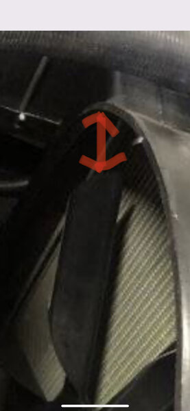

Something else I noticed from your pictures is the distance from the tip of the fan blades to the edge of the shroud. The tighter the clearance here the better a ducted type fan will work. And yours seems to have a lot of clearance.
If I go with an electric fan, I plan to go back to Coldcase (I really like the radiator). They have. Fan / shroud combo for the radiator. The pic of the fan is deceiving, I was nervous it was too tight. The shroud is stock Mopar and the clearance at the top and bottom is only the width of my finger. I think moving the fan and sealing the shroud will do wonders
