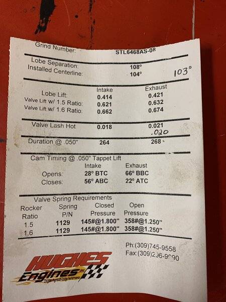

~450hp from stock stroke 340?
Are you running the .590/312 Camshaft.
I have ductile iron rockers which are not a true 1.5 ratio. Lift is just over 600
