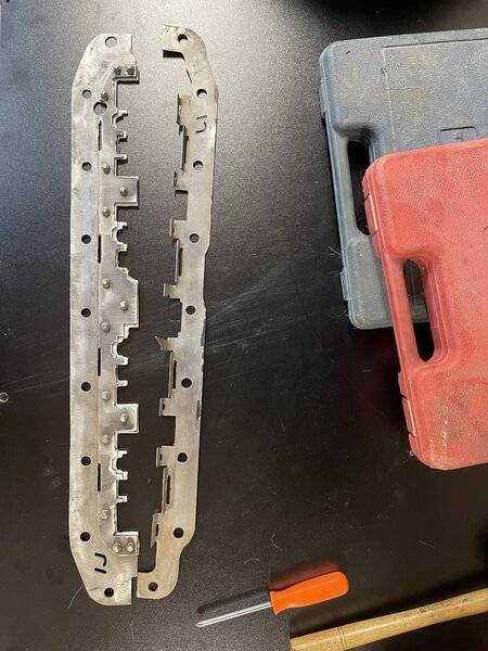

How much of the short stroke V8 hp potential is determined by effective windage control.

This I do know. My oil pressure on the exact same engine with the exact same parts except adding the scraper made my idle pressure go up by 10 pounds both hot and cold.
I use an up and down scraper, plus a windage tray.

When you mentioned the 500 HP 327 I couldn't help but think of Grumpy's discussion about oil winding itself around the rotating assembly. I fabricated a perforated windage tray for my 340 in a effort t see any improvement in oil scavenging, but I haven't needed to swap out a motor yet. Who makes the scrapers for your application.
Ishahra-Johnson makes the scraper I use. It is the one with Teflon that self clearances. If I get in the shop today I’ll take a couple of pictures of both and post them here.

This is an I-J up and down crank scraper with the self fitting teflon insert.
